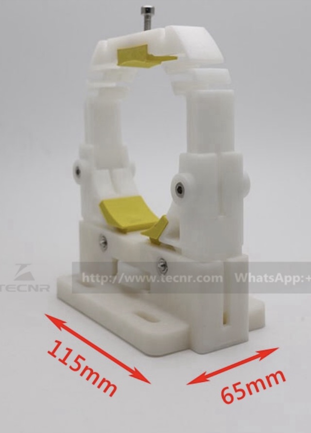

@donkjr Am I looking at it wrong, or does it look like the ebay mount is one size fits all?
@Bob_Buechler did some searching in the community
https://plus.google.com/101614147726304724026/posts/ga4rFbaf6mQ
@Steven_Kalmar it suggests it fits up to 80CM and that makes me wonder how wide those mounts are and if they will fit in the tube bay. Is there a possibly it will take the beam off center enough to make the mirror #1 alignment difficult.
I sent the seller a question @Bob_Buechler perhaps you should as well to get their attention:).
@donkjr they would have to be at least 100 to 110mm wide. Even if they fit, there wouldn’t be enough lateral adjustment to make up for the frame twist of these machines. The mounts on these things need to be as small possible to allow for as much adjustment as possible, while still being strong enough to hold the tube securely.
@donkjr good call. Asked them too. We’ll see what they say. Worst case someone with some design skills can probably use this as a reference.

Looks like those eBay mounts are made by Chinese manufacturer Tecnr: http://www.tecnr.com/sale-9475809-50mm-to-80mm-diameter-flexible-co2-laser-tube-support-mount-brackets-ajusted-for-laser-engraver.html
Their product page says the height is adjustable from 85mm to 105mm. Based on that, and looking at the product photos, it looks like the mount should be around 85mm wide. Still, I’ve emailed their hotmail.com contact address and asked for dimensions there as well. I’ll update if I get good answers.

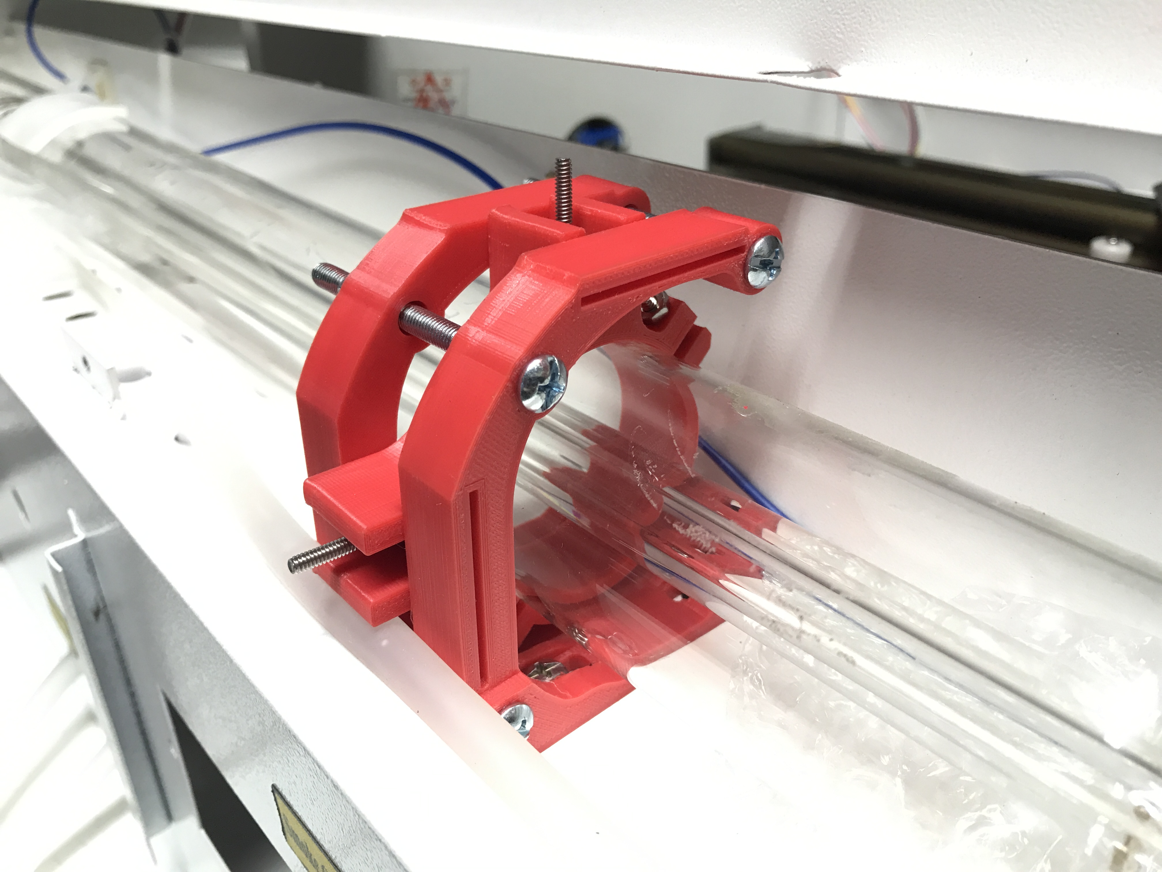

So far I have 20 mm lateral movement and 14mm vertical. There’s room to increase the vertical span by another 10mm at least . The whole assembly is quite rigid, more so than the frame it’s bolted it. I’ll move on to the adjusters and see if I need to increase the vertical span later. Quite happy with the initial print.
@Steven_Kalmar looks great!
@Steven_Kalmar That looks much better than the other clamps I am using, Next time my tube goes I think I will be going over to your’s
@Andy_Shilling Thanks! It will be on Thingiverse when I’m done. Printing another iteration now.
Tecnr got back to me on the dimensions of their adjustable tube mounts. Unfortunately, they are too wide for the stock blue and white K40 chassis:
@Bob_Buechler hey thanks,and darn. They got back to me and told me the tube size it supports lol.
Update: just got the same answer
I bought them for my 50w China and they where to wide. Can’t use them. I need to get someone to 3D print me some
