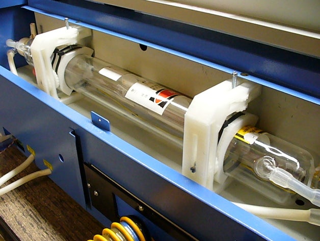

Does anyone know if this Thingiverse design fits the 40W tube diameter?
That says it will fit tubes up to 55mm diameter. The sort of orange layer in contact with the tube is cork, he says he used 1/16" but you can use thicker (or multiple layers I suppose) to shim up for smaller tubes.
My tube measures 51mm, so you’d need an extra 2mm of cork, which would get you up to almost 1/8" total (assuming it’s 1/16" for a 55mm tube). I assume between the cork and the 3d print there would be enough give that the slight (0.5mm) overage wouldn’t matter.

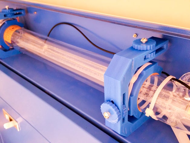

@Bob_Buechler Here is one made for the 40 watt tube
Thanks, @HalfNormal – Same design, just a 40W tube diameter? Or were other changes made?
diy3dtech has made it so it fits the K40. see the videos on the thingiverse link.
I have that on mine but personally I think it would fit better if it was about 5% smaller. It’s very tight in the casing and there isn’t a lot of adjustment making it pointless IMO.

Perhaps we should do what I have seen one other do is make the entire tube and mount one assembly that is removable and adjustable.
This is an example of that approach.

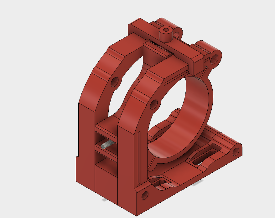

I’m currently working on my own design. I’m hoping it will offer plenty of adjustment. The first test mount is printing now.
@Steven_Kalmar Very cool! How will it work?
The small piece on top bridges both sides of the frame. Same thing goes on the side in front, but the picture doesn’t show it. A couple screws are bolted to the tube clamps and extend out so they can be used for fine adjustments. Nuts on the adjustment bridge ride on these screws and are use to adjust the tube on the 2 planes. The 2 larger holes through each frame will have a couple bolts through them to tighten the frame ends against the tube clamp to make everything solid. Then the adjustment bridge pieces can be removed, or just left in place. They will snap on and off and slide in the slots on the side of the frames. I have a couple frame pieces printed. They are small, but appear to be quite rigid. It should be very solid when everything is bolted together. There are some slots in the base to allow for some movement there. I may have to make the bottom base a bit shorter. I’ll have to see once it’s all bolted together.
