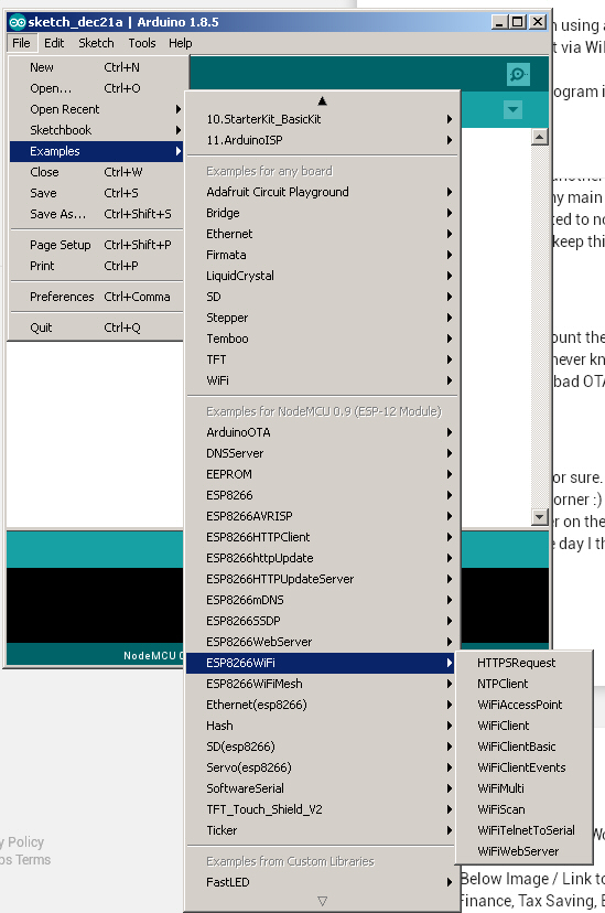

I have a couple ESP-12E NodeMcu V3 module and found out that yes you can. Here is some info on this topic.
http://esp8266.github.io/Arduino/versions/2.0.0/doc/ota_updates/ota_updates.html
Also, play around with these scripts. Open up the serial monitor to get results. I did this to isolate the issues with sending data from on application to the ESP module.
