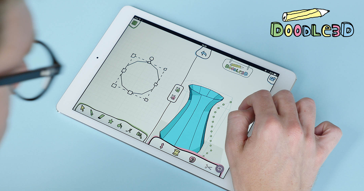

Have you seen this program/app:
Pretty basic, simple to use, definitely child level graphics.
