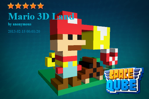

Does anyone know what kind 3D printer I should look for if I want to print the voxel model as my picture shows?

One of the online one off shops would do that for you reasonably cheaply. Otherwise you’re looking at a very expensive printer. There’s lots of overhangs there and I assume you want color. Only real option for all those needs is a (pricey) powder printer.

Sorry this picture is just a sample. I will reduce the overhangs if I need to print it out. In this case (without overhangs), any suggested printer for me to look at? I want color too but I don’t mind if the printer can print the model without colors. Thanks.
Any printer should be able to print that in a single color if you just orient the piece so it’s face is flat on the bed. But there are a lot of colors there and you’d lose nearly all the detail that way.
You could possibly split it up into multiple prints (if you wanted all those colors) and assemble them post-print, and maybe use a dual or tri-extrusion machine to keep the costs down without having to go with a full blown powder printer.

I’m sure the Afinia could do everything but the colors - which no current consumer/pro-sumer printer could accomplish.
