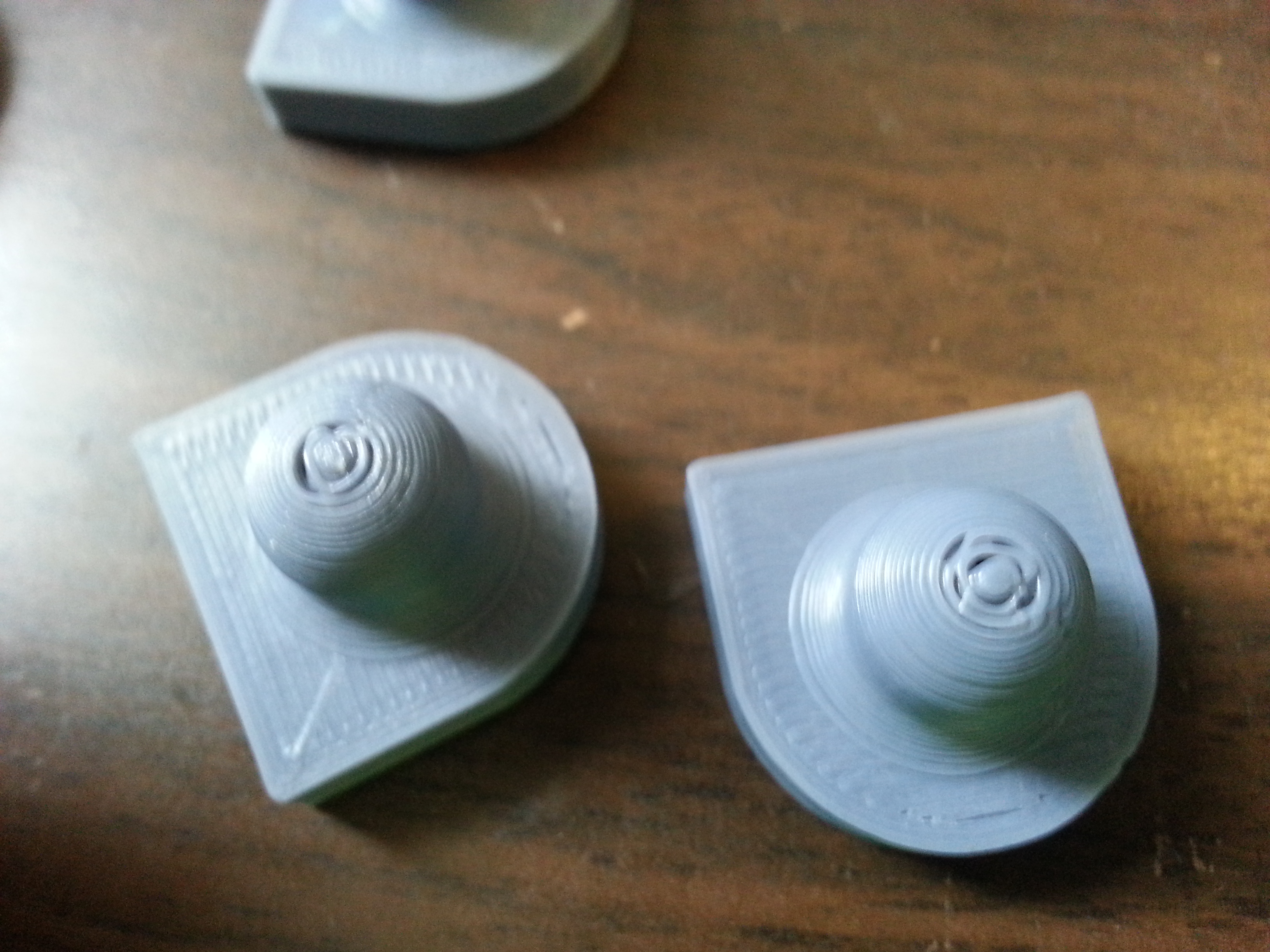

Does anyone know what skeinforge settings I should be adjusting to fix these defects?
Does anyone know what skeinforge settings I should be adjusting to fix these defects? I’m running sailfish on a thing-o-matic and have the prints coming out very nice other than surfaces like this and some ugly zipper.

Increase infill, increase top solid layers (can’t remember what the exact setting is called in SF), increase cooling, decrease temperature, increase extrusion multiplier. All or either of those can be a part of fixing this.
But really, switch to a modern slicer as they do have some smarter means of detecting (and dealing with) areas like these that need some extra attention. Both Slic3r and Cura(Engine) are good options, even if Slic3r is rapidly morphing into Skeinforge these days.
In addition to what @Thomas_Sanladerer said, see if you can decrease the layer height. If you print shorter layers you won’t need as many top layers to get the same filled effect.

Thanks again all. slic3r gives me smooth round tops but very sparse flat surfaces so I need to keep fiddling with that.
