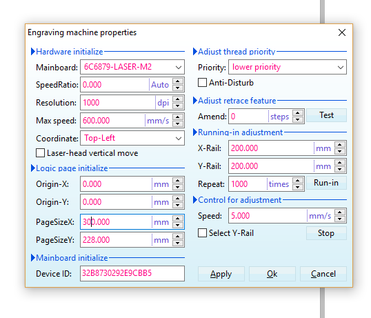

After you get it installed you will need to go into the device initialization settings and make a few changes. If your control board says M2 nano then make sure the mainboard is set for M2 like shown below. Next there will be a serial number for your board, usually on a white sticker on the board. Write down the number and enter it into the device ID field.

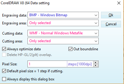

I would also recommend these settings in the CorelDraw settings. For earlier versions of CD (like version 12) the “Engrave data” needed to be set to WMF, but I found that with newer versions of CD I had less issues using BMP in that field.
I was about to ask that lol! I see some ppl go with JPG/PLT and others both set to WMF. Is there a difference…does it matter much?

I think which cut and engrave data type you use depends on the source file going into Corel, the main thing is if your cuts/engraves have issues with placement, try different setting for the data, for me HPGL did the trick. But thats history now that I have the Cohesion Mini running the show.
