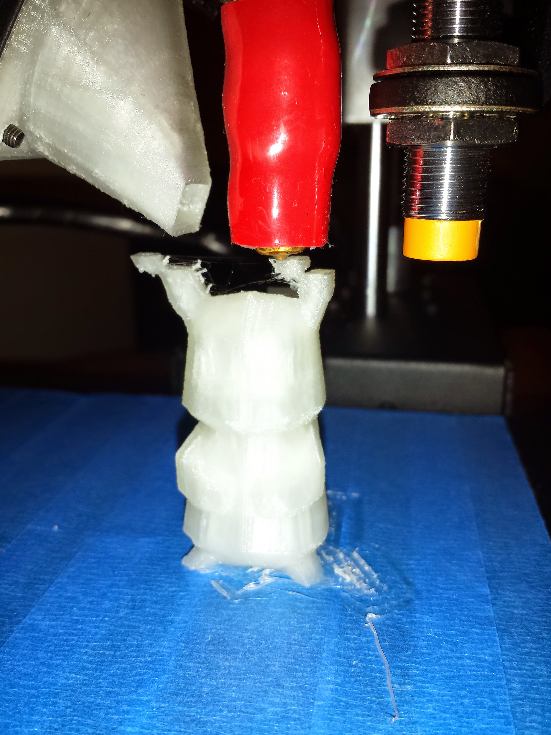

Does anyone know why while my printer was printing it just decided to print
Does anyone know why while my printer was printing it just decided to print the model a few millimeters to the right? I have the printer bot simple metal kit.

Cause of this for me so far has always been a bad or improperly adjusted stepper driver. They are small and fairly ill suited to the kind of abuse we throw at them and need to be replaced every so often.
These kind of things often happen if the nozzle gets stuck somewhere while moving around, and the motor current is not high enough to overcome the mechanical resistance - then the motor loses steps.
In this particular case, this seems to be the case: Note how the offset is more or less exactly the thickness of the ear. Probably the nozzle came from the left (all seen as in this picture) after printing a layer there, and moved to the right. The slicer had planned to start extruding on the right side of that ear, so the nozzle had to move across the ear.
However, the nozzle got stuck at the edge when hitting the ear (maybe a little bit of plastic was sticking out), so it didn’t move all the way (and since it was moving, it was typically faster than printing, which in turn means: less torque).
So it got stuck on the left side of the right ear in the picture, assuming it was on its right side and printed from there. This explains the visible offset. The motor doesn’t have any feedback, so doesn’t know that it is off … so this was its new normal from then on.
To fix: increase motor current and/or print slower. Also, there are slicer settings that tell it to go around already printed things when moving.

The model seems fine to the poitnt where the head has to accelerate between the ears. I would check non printing move speed and then it may be related to a sticky bearing loose belt skipping steps.
Looking at the bottom layers of your print (not the ears) I’ve had something similar in the past with PLA, when too much plastic gets extruded on the first layer. The nozzle was hitting the bumps and not making a full return in that axis. As the gentleman above says, tighten belts, lubricate bearings and for the base layer, check your slic3r settings.
