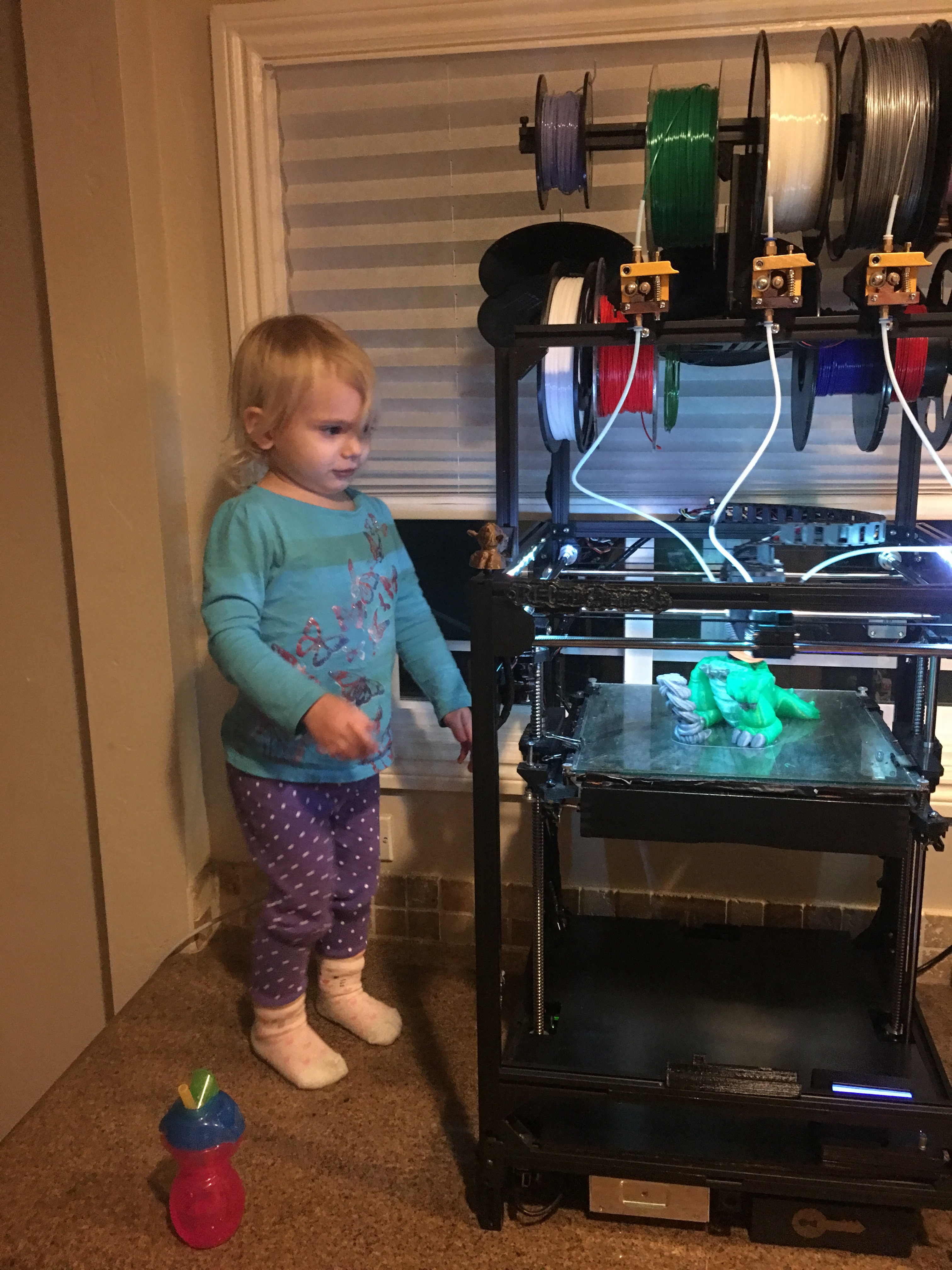

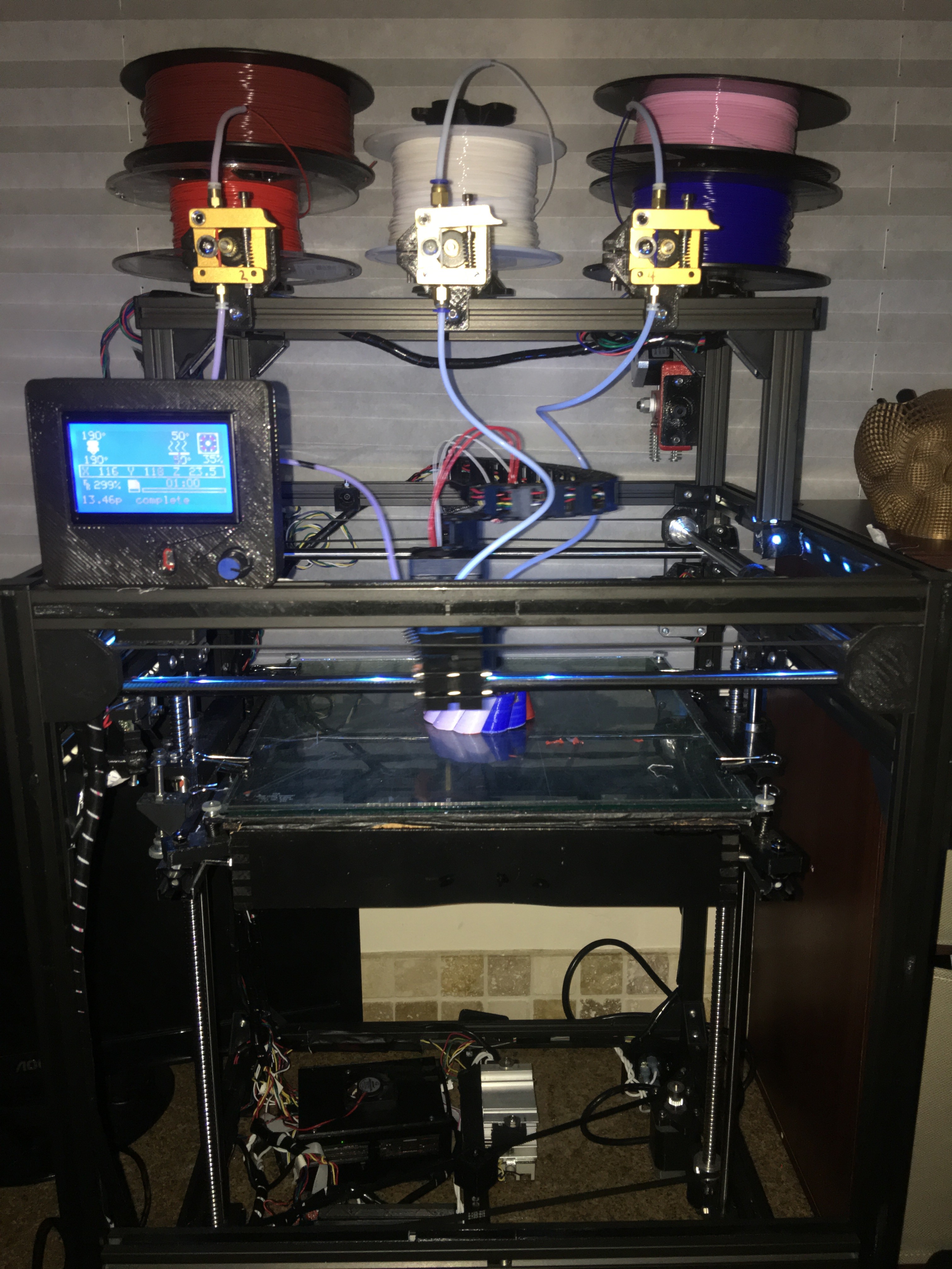

I’ve been using a Diamond Hotend for the past couple of years and really enjoy it. It is temperamental, but I’ve gotten some great prints from it, and tested successfully with TPU, soluble, and wood filaments. It does have a tendency to jam, which will ruin prints, but most of the time the jams clear easy enough. I assembled a structure that sits on top of the printer to hold the filament and motors, and feed the filament down from above.
@Carter_Calhoun1 wow, I can’t believe I missed these comments. I never saw your setup in pictures before. Thank you very much for sharing. I should make a post asking for everyone to post their machines pictures. It will be good to collect them from examples out on the GitHub.
