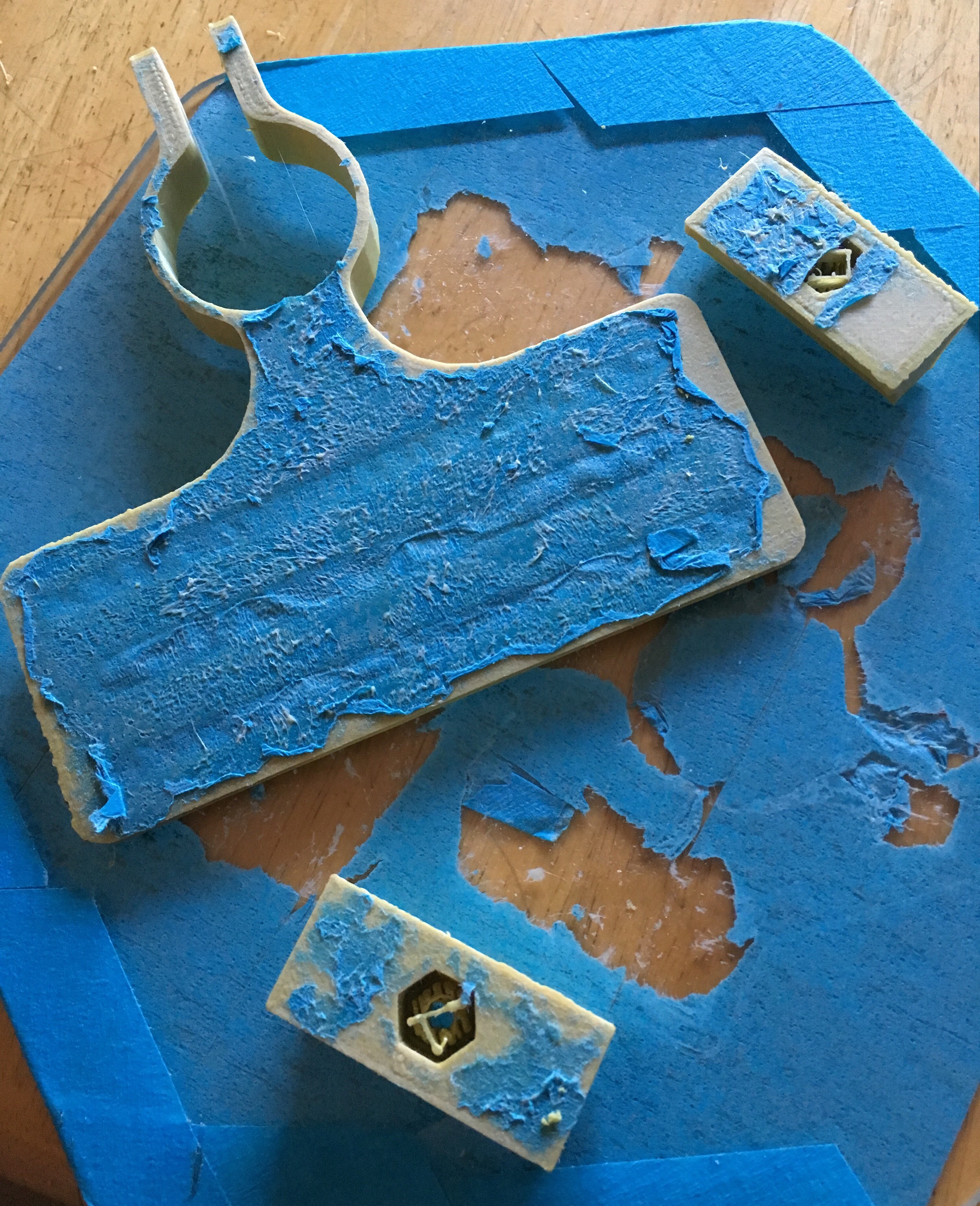

I use Harbor Freight tapes that yields to heat. The first layer sticks extremely well - no more cleaving/warping like with 3M. This solves my early trouble with adhesion, just too well. I tried glue stick/hairspray on top of tape. They ease tear, but does not prevent it especially during larger prints. So I didn’t bother with this print.
Previously I used scraping tools, even sanding and filing. But this time, I tried to wash it off with steel wool used in the kitchen. It works quite well. (The second picture exposes the bottom sides.)
Looks like, to me your first layer is too low. I never have that issue with blue tape unless I wipe it with rubbing alcohol.
I agree with @Keith_Applegarth . I can see some overextension in your first layer that could cause the issue. Like he said this only happens for me if I rub down with alcohol. I use Duck brand tape though
To remove, I soak the whole thing in alcohol.
@Keith_Applegarth Are you using the 3M tape that everyone recommends?
Yes, part of my first layer is low, in part because I can’t get auto bed leveling to completely level so some corners are deeper. I suspect that I have some tower alignment issue, but haven’t found an easy way to eliminate it. I’ve watched some manual adjustment method to set G29 that is really painstaking. Meanwhile, I’ll see how far I can lift first layer without the other corner cleaving.
@Griffin_Paquette You confirm my impression that different brands have vastly different properties. The original 3M tapes on Ares 3D printer’s plate is hard for the first layer to adhere to. I tried glue stick/hairspray on the bare glass for some time, but result was very inconsistent, and warping was severe. After I use Harbor Freight tapes, adhesion problem and warping are completely gone. (Another Canadian on the Ares forum also reports a home improvement store brand tape having similar properties.)
For me, water and some abrasive tissue remove this tape perfectly.
@whackyhack I have switched between glass and glue stick/hairspray and blue tape for about two years. I never had a ton of luck with either until I switched to the Duck brand. I just wipe it down with alcohol if I really need a large part to stick and never worry about it again. It’s crazy good. No separation between the tape and the bed not the tape and the print. Check out my post from a couple weeks ago. I made a quadcopter arm that was over 200mm long without any heated bed and it was perfectly flat.
