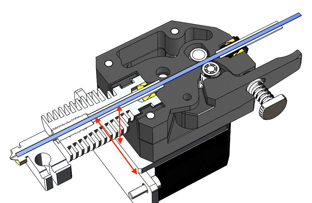

@Martin_Bondeus alternatively, I need to know, where exactly the filament path is, relatively to the alu-mount. Could you provide such info?
A step model of the BMG is available on the product page. You can measure that. I did not find a model of the mount, but some dimensions are described on its product page.
I REALLY looked for it and only found a half front and all the mounts?!
The model available is a simplified step (no motor since that is up to what you want bolted on). See picture, sorry had to open the step file on my phone.
He has an STL for the printed mount:
Here are a few dimensions I could pull for you if it helps. Measurements to centerline of the motor shaft and off the back face of the extruder housing.
@Eclsnowman Thank you very much! I think, that will work
