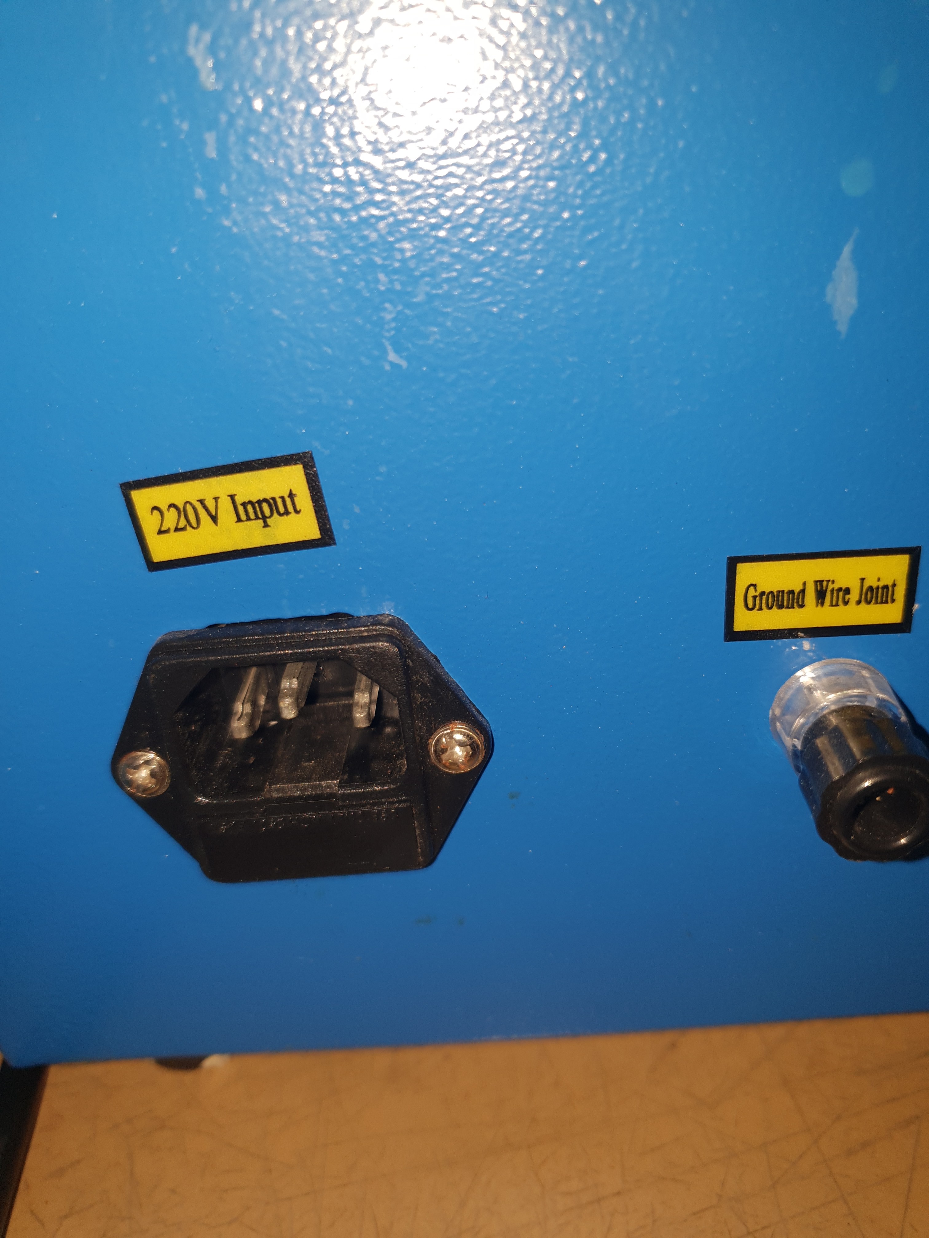

Does my K40 need grounded? I live in the UK and we have 3 prong pugs. We don’t usually ground stuff.
Change the cable to a proper 3-pin cable. The one in the photo looks like it had a 2-pin plug and the Earth pin on the adapter looks as if it is just a dummy.

Replace the mains lead with a proper british spec one. test from the earth pin of the plug to the chassis of the K40 to make sure it is internally wired correctly. Then you are good. I would trust the ring main earthing to be better tested and protected (by your RCDs/MCBOs) than a cobbled together seperate earth would be.

Just bin the supplied cable and its death-dapter, they will not be properly earthed and may well be actively dangerous to use, use a good quality standard british spec “kettle lead” instead.
Then make sure whoever assembled the k40 didnt cut corners, ensure that the earthing wires inside are properly secured and wired, do an end to end test with a multimeter to make sure the chassis and psu grounds are properly wired to the mains lead earth pin.
Thanks for the replys, I got a proper 240v lead and plugged it in. Just like the normal UK plug. Thankfully it didn’t kill me.
@Aaron_Cusack please do a quick check with a multimeter set to resistance or continuity test, between some bare metal on the chassis and the earth pin on the plug. just to make sure they didnt leave off the earth wire inside the case
