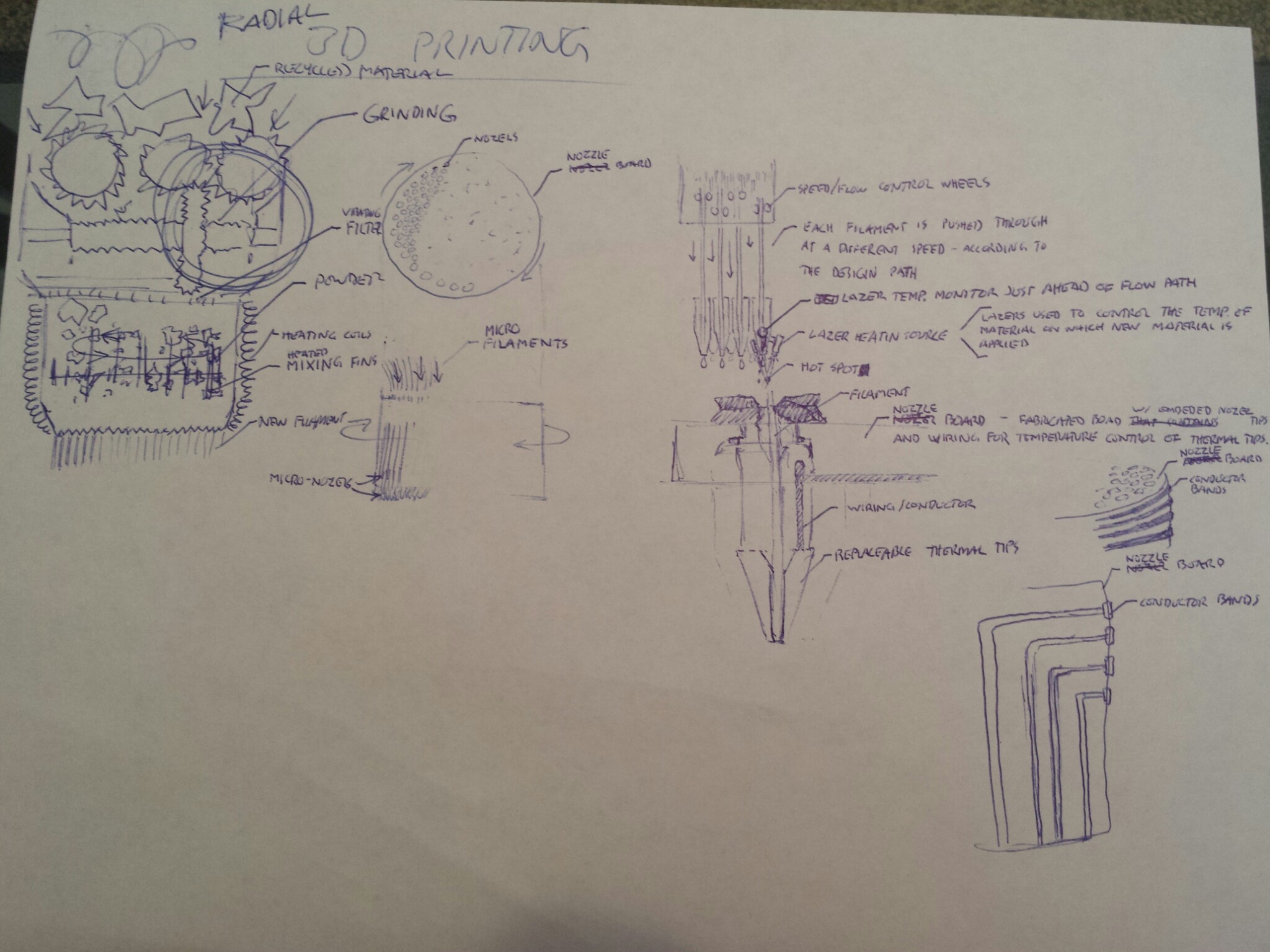

I created this crude sketch of my ideas for the Multi-Nozzle Radial 3D Printing process, but my lack of experience only produced more questions.
How does an experienced and more educated group address this possibility? Is it possible, or does it offer any benefit(s) for any type of 3D Printing project?
There was a kickstarter somebody posted about a few weeks back. The cons far outweigh any pros. In terms of smooth surfaces, there really is no reason an r/theta setup would be any smoother than an x/y. The surface finish is more associated with z height, system rigidty, and calibration calibration calibration…
That makes sense. Is it not possible to program output for continuous growth z? I was thinking that combining the Multi-Nozzle with continuous x-axis motion, would reduce Flux in temperature and provide for a more consistent layering. Thinking in terms of the helix…
I was also hoping that the continuous motion would reduce wear on mechanical parts. Do you have a link or title that I can use to find the Kickstarter project?

This kickstarter was one of the worst ideas in 3d printing I’ve seen yet. There’s some interesting stuff in your sketch, but all of it is unproven and unlikely to work as you imagine.

How would one keep constant speed through a hard bend close to r=0 in a r/theta setup? Is it harder to spin 90° than to go full stop on one axis and accelerate to full speed on the other?
The high density of nozzles on the Nozzle Board would compensate for acute angle surface variance and void areas. (pure theory at this point)
@Hannes_Lilliefeldt it’s worse than that. Even for a straight line passing near r=0, the required speed of the rotational axis approaches infinity.
Ahhh… I see what you’re saying. I was making the assumption that you could cycle the flow of filament (on/off/on) similar to a standard ink jet printer, but I now see how that would potentially create more flaws in the final product. Hmmmmm… Is there a way to improve on the responsiveness of flow control?
