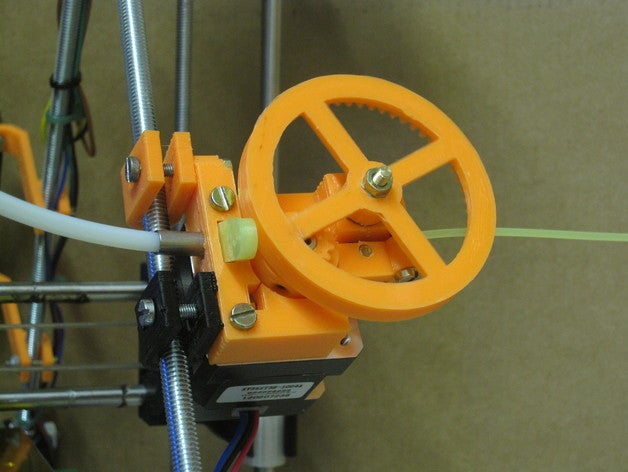

however I had recently a problem with this design. All the power of the motor on the wheel is discharged on the small plastic around the hexagonal central bolt. By mistake I tighten too much the filament pressure screws, and since the bolt was completely blocked, the wheel rotated by breaking the 0.7mm if plastic around the hexagon hole making it ROUNDED until it was loose.
It would be better to have a bigger nut or something wider to offer much resistance surface.
