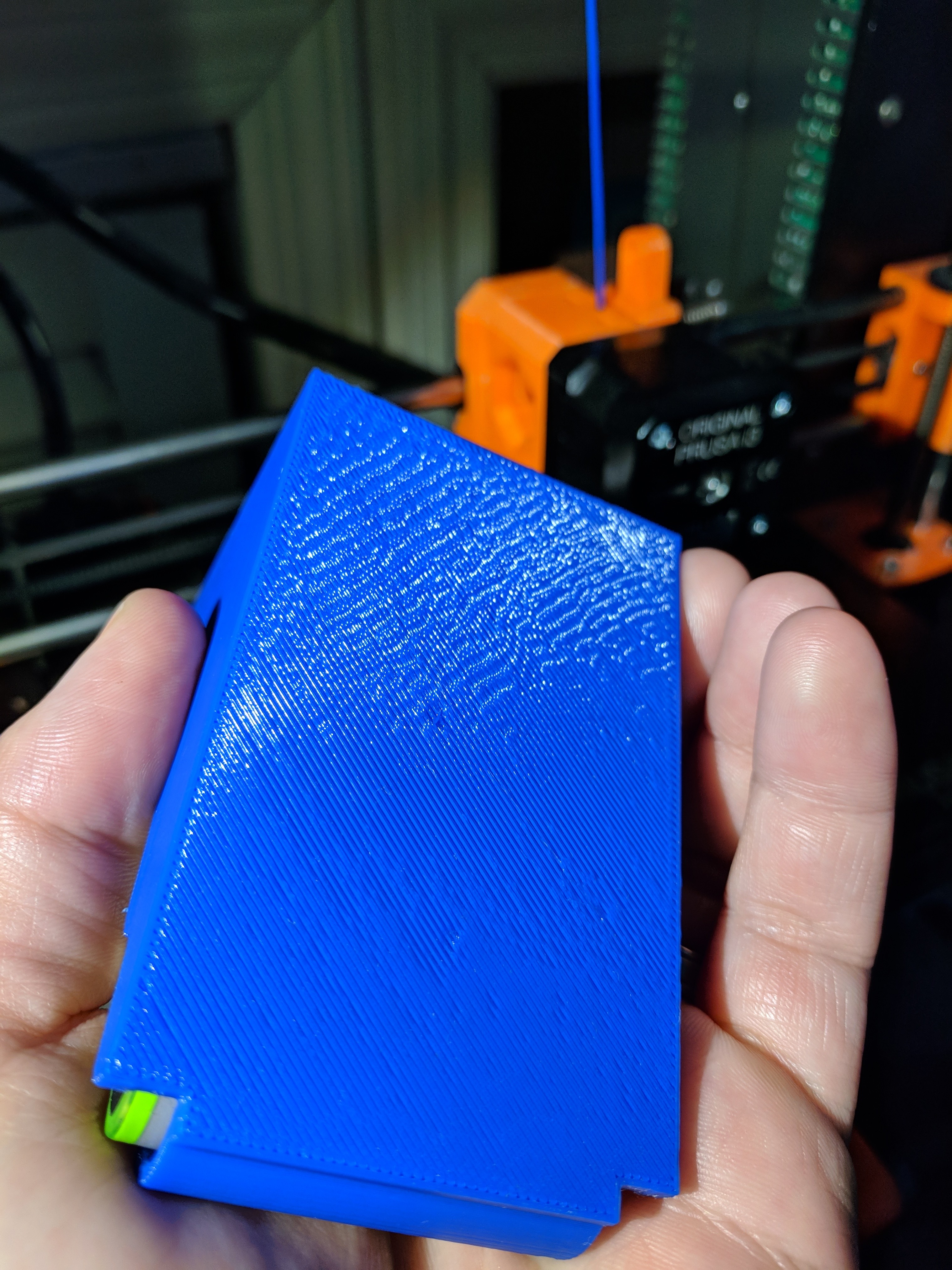

does your first layer hight grow over time? it's like the bed is 'settling',
does your first layer hight grow over time? it’s like the bed is ‘settling’, moving further away from the head. that doesn’t seem normal?
Its thermal expansion. Let the bed sit for about 15 minutes at temp before starting the print.
