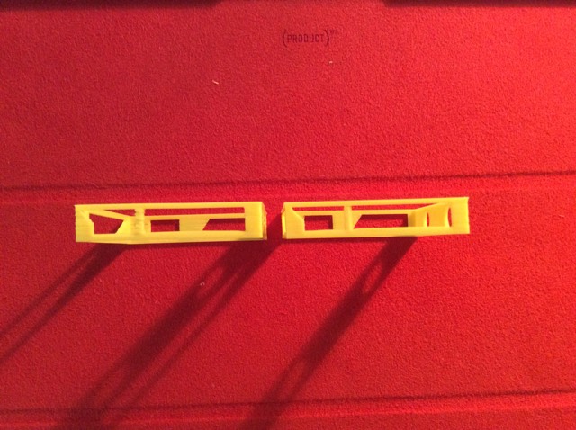

Doesn’t get any better than this… 1st and 2nd trial of retraction/bridge torture test (Ooze/Retraction Test by wemperor - Thingiverse) with the beloved #saintflint .
There is some additional tricks justifying the difference between the two:
- Not letting the slicer optimize the hotend travel. It means that everything will be printed sequentially, thus avoiding the very little island to be printed twice when the first layer isn’t completely cold yet.
- Get the temperature right for the material (1st was at 205ºC and 2nd, 215ºC). Your mileage may vary as usual.
