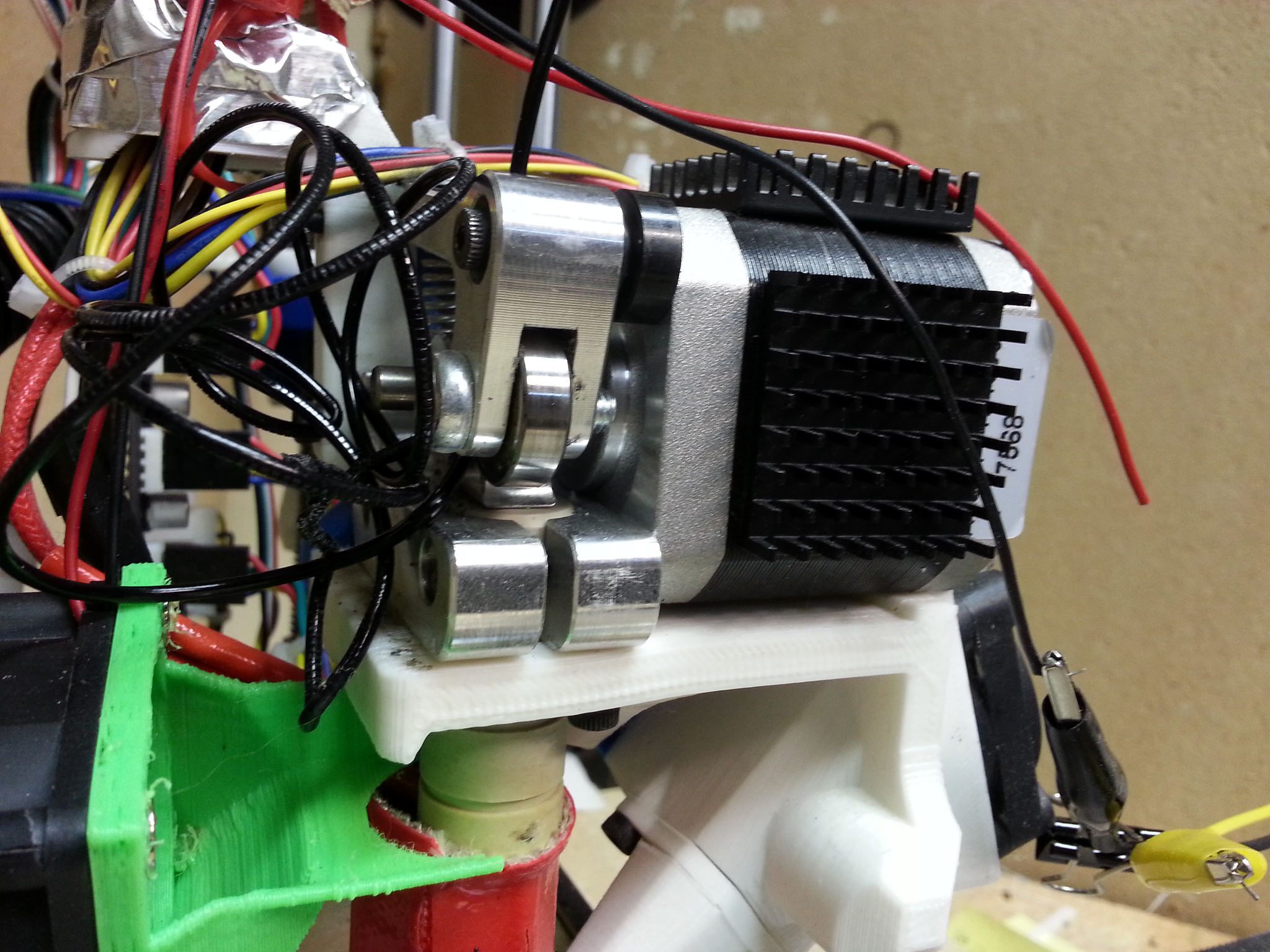

I cleaned up the previous mess (https://plus.google.com/u/0/+AlexWiebe/posts/DevnYpENVCY), made sure to turn on (ie: connect) my extra cooling fan and restarted the job.
Came down to find this disaster awaiting me.
So, clearly I need to:
  1. Construct a more robust power connector for the cooling fan (follow the red wire on the right to the yellow aligator clip)
  2. Snug up/redesign the (green) cooling fan shroud.
Mondays. Ugh.

What’s with the heat sinks on the motor? If the motor is getting that hot, then something is likely not right with that.
Have you tried lowering the current to the extruder motor?
@Taylor_Landry The heat sinks were an early attempt to cool the entire extruder/hot end down. Normally the stepper barely gets above 35C. The heat management is all around keeping the heat-creep from the hot end down (thermally as well as physically).
I had the same issue with my printrbot, as a matter of fact I was not able to print at all without a huge fan next to it. Later I made this: https://www.tindie.com/products/FemtoCow/printrlight-light-and-extruder-fan-holder-for-printrbot-simple-2014-2/ It’a a 60mm fan holder that attaches under the extruder motor and blows air directly on the extruder. There are also LED lights on the bottom to illuminate the print. Works well now. Didn’t need to install heat sinks on the motor as I planned.
I don’t use my laser cut Simple much anymore, but I too at least have a 40mm fan on the front of the extruder to help keep things cool. Between that and a new Ubis hotend, it prints like new.
You could print the fan duct that they used to use on the old ubis 13 and shove it on the top section.
Send me your address and I’ll send another hotend- the v2 extruder is a lot better on tolerances if you still have a v1
Thumbs up :wink: nice gesture by @Brook_Drumm to help him out.
When I had the same issue I also got the newer hotend, absolutely no improvement.
You need to turndown the current and slow down. That was the fix for me.
