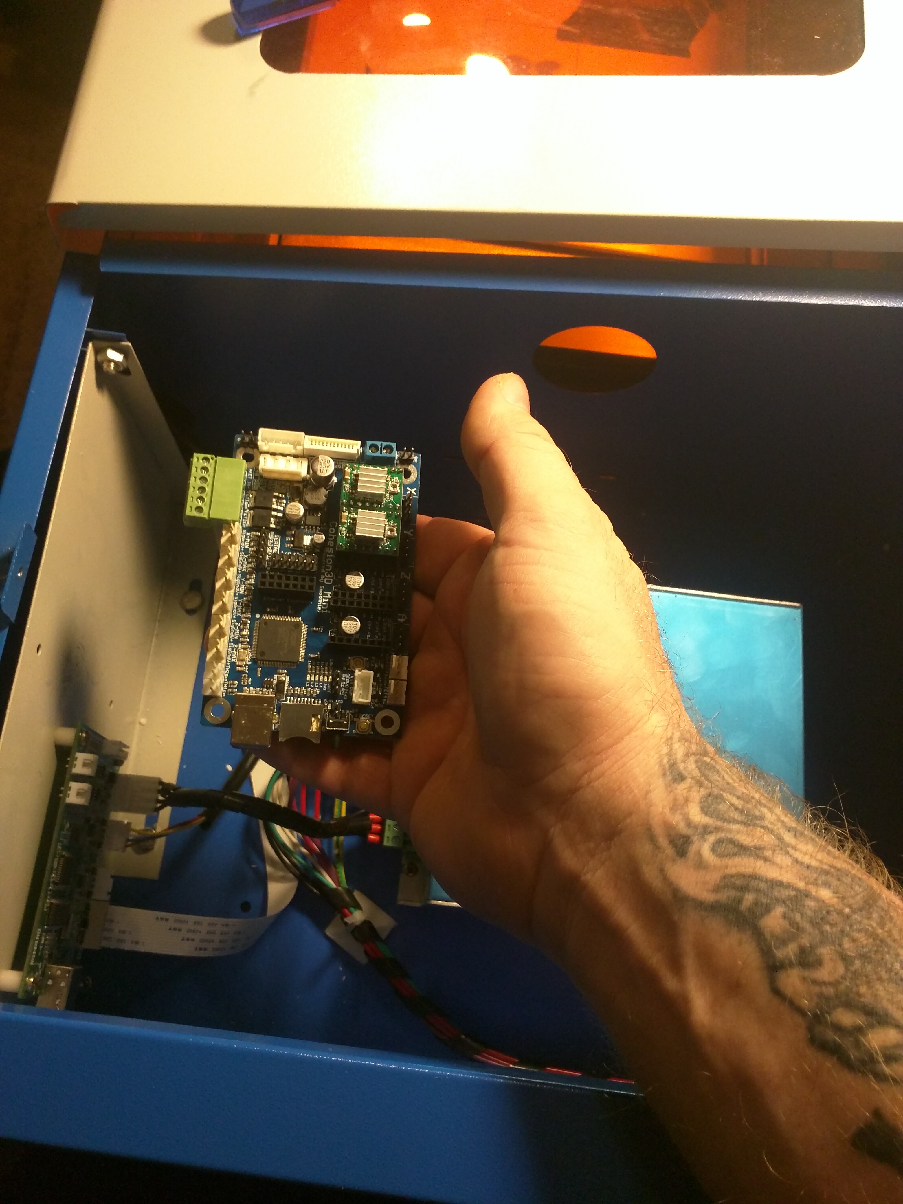

Doing my smoothie swap today! @raykholo
Here goes…

It did go smoothly… BUT… I’m having issues getting it to connect to laserweb… Any suggestions please?
What OS are you using? I had a very hard time doing it with Win 8 had to upgrade to Win 10 to get the Smoothie board drivers to work - did you have any problem installing them?
I did not think that under WIN10 you needed drivers. @Arthur_Wolf ?
@rick_jarvis did you follow step by step the installation instructions. It must be exactly in the same order or it will not work
i did follow exactly yes, and i did have to install drivers. i get laserweb up theres no errors showing for drivers… i just cant get laserweb to connect to the machine. thanks
What com port shows in LaserWeb? Check with Device manager and see if that port is working ok Are green lights flashing by the USB port on the Cohesion Board?
Yes, make sure it is the smoothie com port and not the smoothie sd reader com port
Good luck .
win10 does not require drivers for the serial, in fact installing drivers will make things wobbly.
So, going down the list:
Installing Drivers if necessary. Windows 10 - no. Other earlier Windows - Yes. Other OS - no. http://smoothieware.org/windows-drivers
Putting the config file from the dropbox link provided to you onto a microsd card. Insert card into board. Plug in USB. Green LEDs should turn on, 2 should flash on/off. Board/ memory card should show up as flash drive. Start Menu --> Devices and Printers should have a ‘Smoothieboard’ entry and double click that, go to the hardware tab, and confirm the COM Port for the board.
Confirm this is the value in LW, along with the proper baudrate (default in config is 115200 aka 115k), and hit the green connect button.
