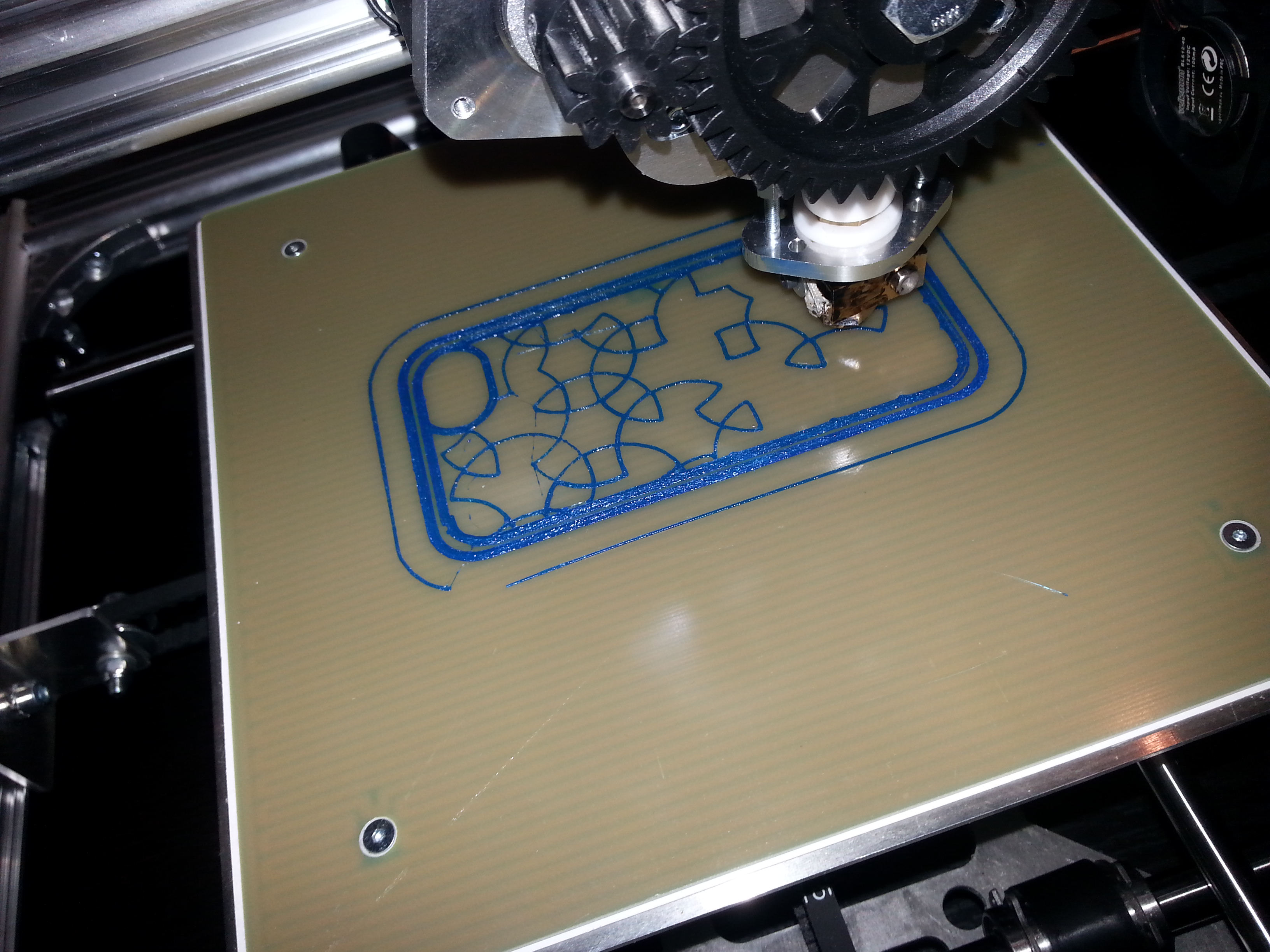

Doing objects and testing different parameters of slicing and different parameters of speed from
Doing objects and testing different parameters of slicing and different parameters of speed from the panel setting of Rep. Host. Still not very clear.
Often pieces are not well stuck to the plate and sometime they move :frowning:
