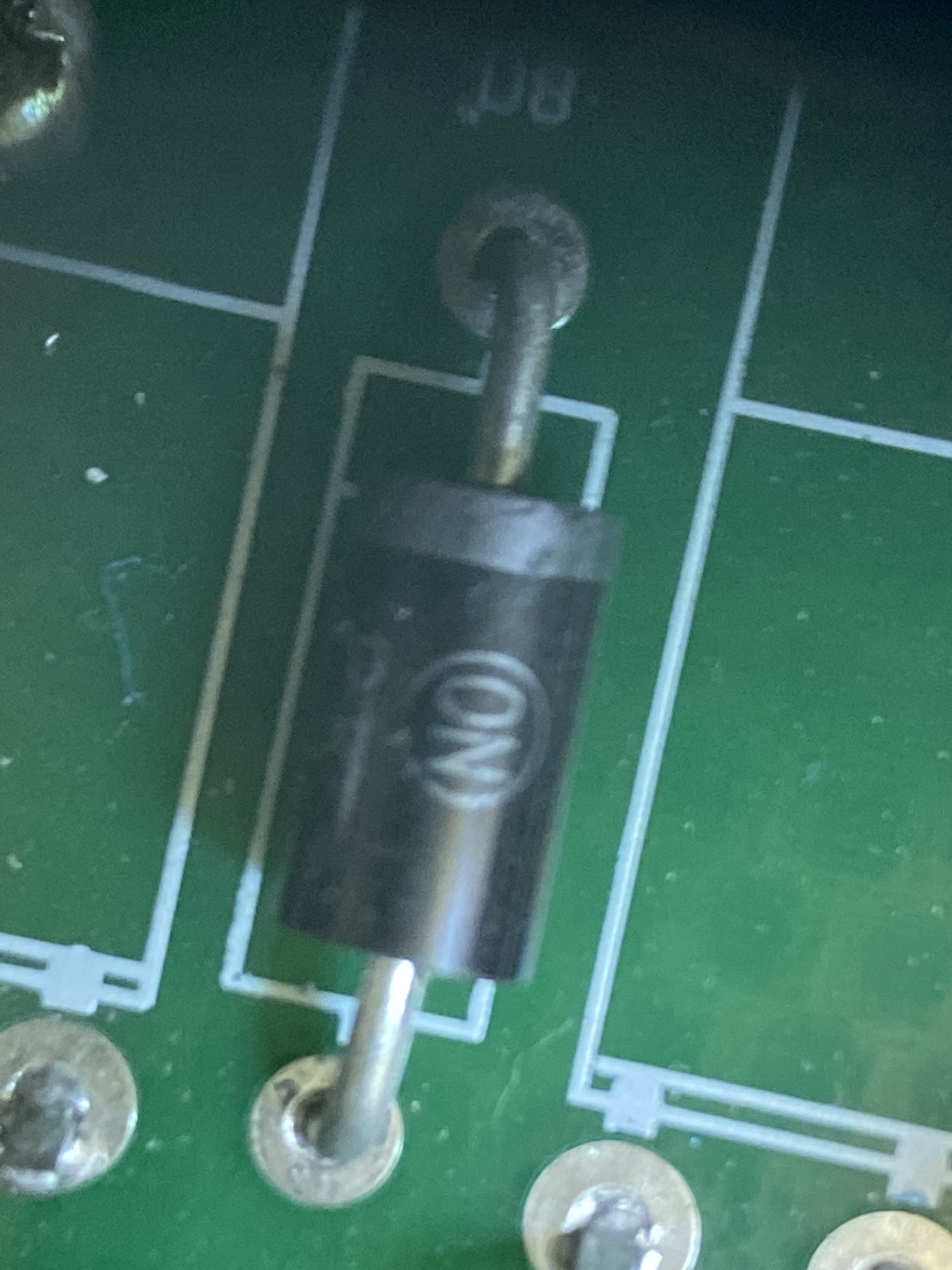

So after getting it back up and running by replacing the board, it was working like a dream. Then I shut it off one night, next day turned it back on and poof, tripped the breaker. Turned it off went and reset the breaker, poof same thing. Checked the fuse and it had been blown to hades and back. No where local had them so had to order some. Got something else in today that has the correct fuse (250v 10amp 5mmX20mm) and thought awesome, here we go! Poof, trips breaker. Unplug everything in the room so that it is the only thing pulling power, poof. Plugged it straight into the wall, poof. So I got to looking: unhooked everything from the power supply, turned the laser on and the fan spins up like normal, turn it off unplug it and plug the power supply back in, turn it on: poof. But due to having the control side of the laser open, I was able to see a bright light around what is shown in the picture, and audible pop. There is then that “ o zone” smell?? So first the board and now I think the power supply has went out. Your thoughts?

$0.02, That part in the picture is called a diode and it’s job is to let electric current flow in one direction and block it from flowing in the opposite direction. If you are seeing arcing across that diode then I can only guess your showing a part in the high voltage(HV) section of the power supply. ANY HV arcing would make me check to see ALL of my wires connecting from the HV output of the LPS all the way back to the L- of the LPS are properly connected.
$0.03, when an electrical device blows a breaker, the ONLY time I might repower the device after the breaker was reset is if there were other devices on the same circuit and the possibility of too many high load devices caused an overload and NOT a device failure situation. Trouble shooting by unloading and then slowly loading back up is something to do with caution and a fire extinguisher nearby. Also eye protection.
Also looking at the picture again, the solder around the pin of the diode does not look complete and I would look to see if the diode lead/pin is also sticking too far through the hole and contacting the metal case of the LPS(under the circuit board). Surprisingly the diode does not look to have destroyed itself.
That diode does look like it has a cold joint!!!

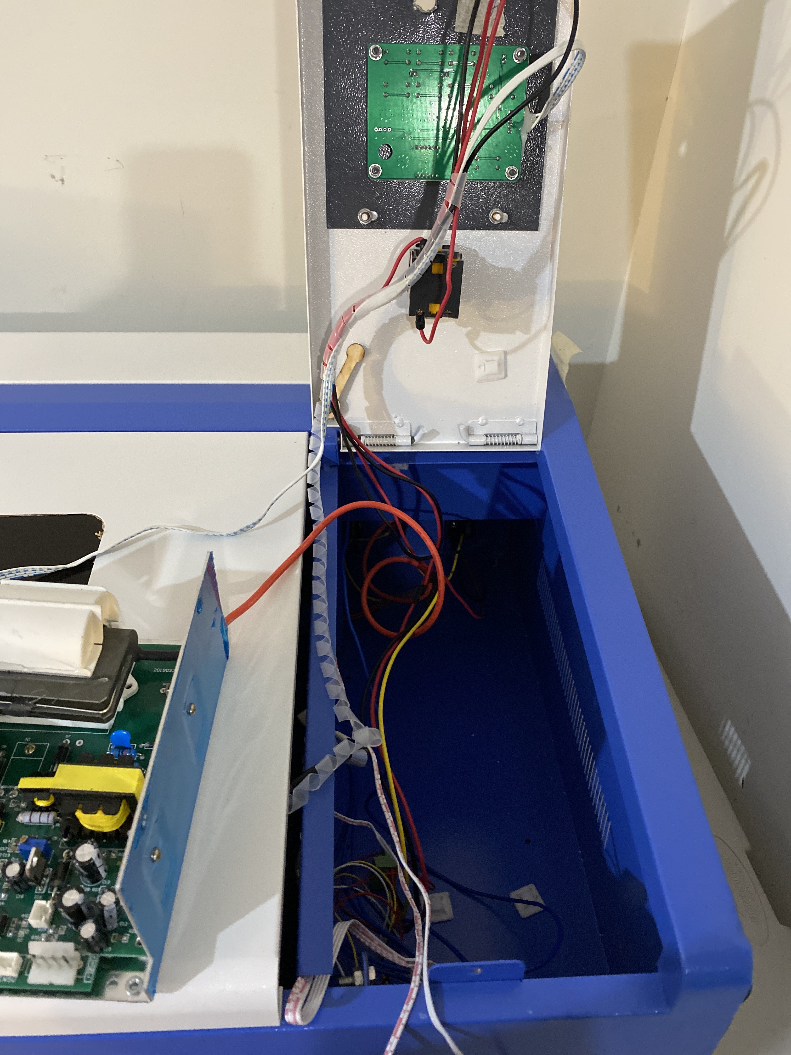

This is what I refer to as the control side:
The Nano board

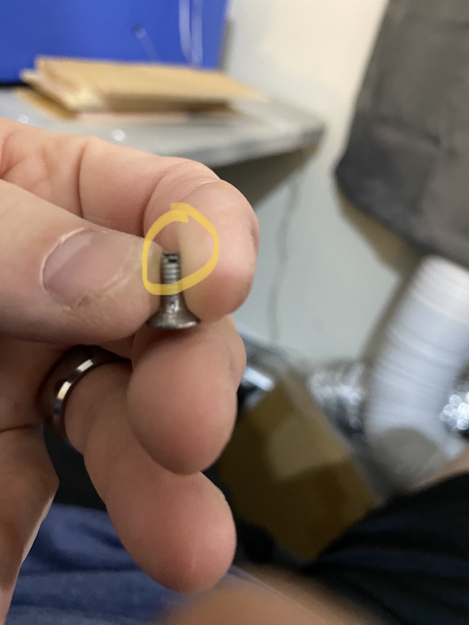

Now with that all said, I removed the power supply box and was taking the cover off (to get better pictures of what I was talking about. When I looked under the power supply board there was a random screw which to me seems to have some burn marks on it. No clue where this screw came from as nothing is missing.
I have since removed it. Let me know if you need more or better pictures. Again, thanks in advance for everyone’s help.
What do you guys think, the 24VDC or 5V was shorted out by the screw but no idea why it might cause the flash back in the HV section unless it effected the laser triggering circuit. Anyways, I think Don has a LPS( Laser Power Supply ) troubleshooting list which probably starts by having everything disconnected but AC input to the LPS and then low voltage measurements( 24V, 5V, etc ), pushing the Laser Fire button to see what happens, etc…
There’s a good chance something else went wrong/failed when that screw shorted out parts of the LPS circuitry.
