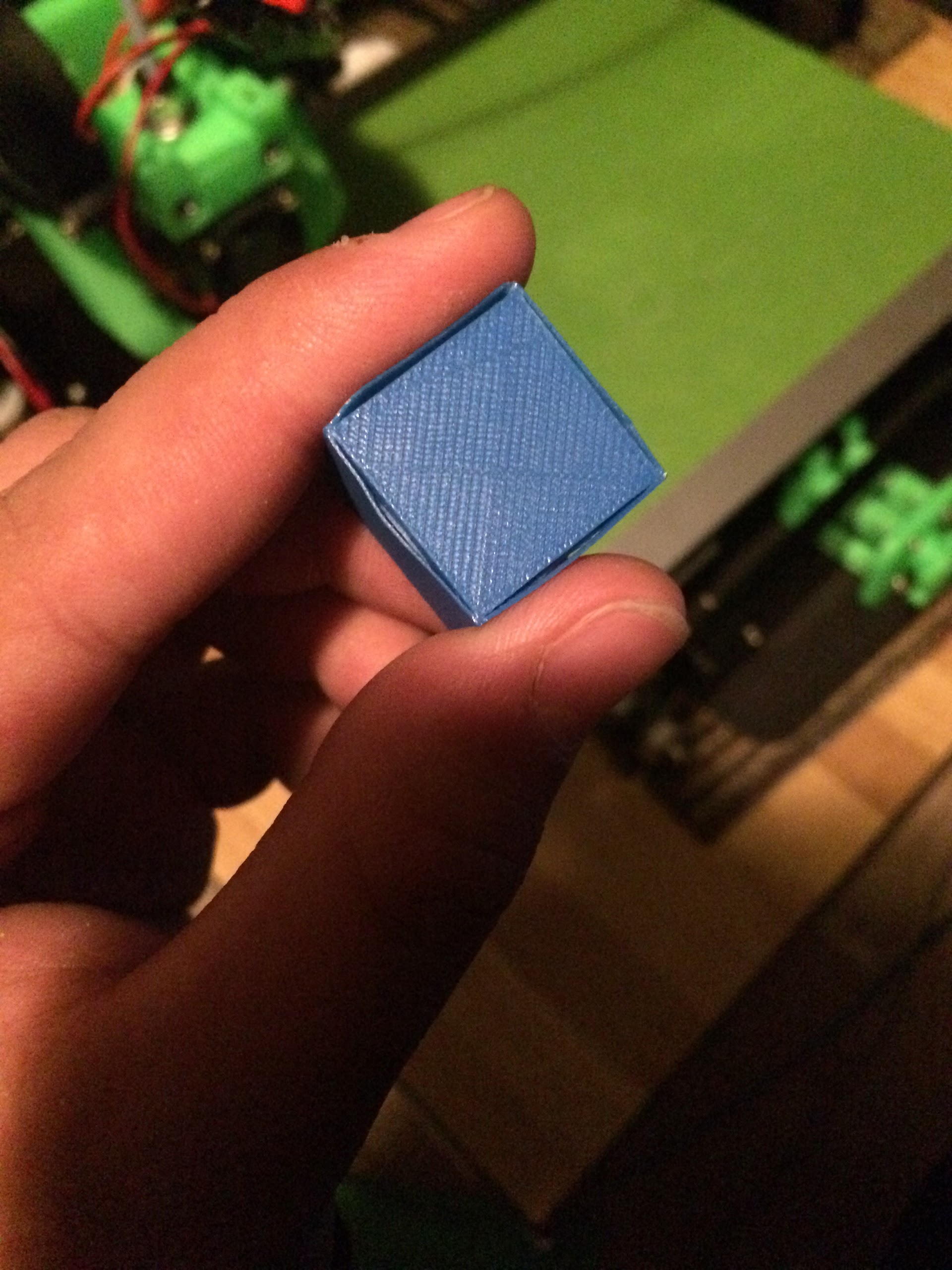

Dose anyone know how to fix this.
Dose anyone know how to fix this. The outer walls of my print do not stick to the rest of the print or the top surface.
First thing to check is mechanical backlash. Then extrusion volume settings. What have you tried? What is your printer and slicer?
Overlap percentage?
what?
I use CraftWare. In there you can not only set the overlap, the outer wall thickness, etc, but see it on the screen after slicing. I guess other slicers show that too, but I only know CraftWare. I saw after slicing that this was to happen so i could tweak the settings.
I have seen it when you go too far as well. When you preview the slicing, dies it look like it is printing?
Do you use heat bed? If not try using it and you would Get better prints
So it ended up being under extrusion, but it was from a bad nozzle that was restricting flow not software. Thx everyone who helped.
