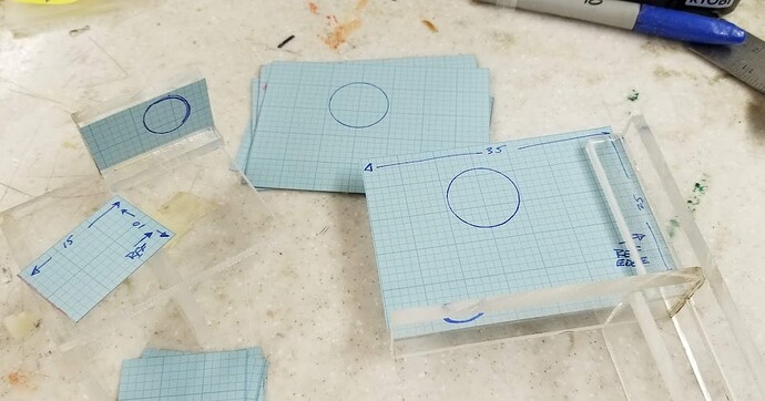

I dealt with this overall problem on my machine some time ago by making sliding targets aligned to the gantry so that I could accurately profile the beam as it traversed the X & Y.
There may be a simpler way to try this:
You can try this and it occurs to me as I am thinking about this problem that this same method could just use a piece of stiff graph paper held in a consistent reference to the gantry. This template is not as accurate as the acrylic tools but probably good enough to see a big problem.
This target would be placed and held vertically at various positions along the beam path and test-fires would be performed over the top of each other at positions between the mirrors. The result is that you could see how the beam moves along the path in X and Y relative to the gantry.
This attachment can be printed 1-1 on stiff card stock (or glued to something stiff) cut out and then used as described above.
This template mimics the dimensions of my tool. The circle is the region that the beam should be in. It can only be used for the path from mirror 1 to mirror two. If the laser is not parallel to the gantry axis it will likely show it along that path. I will create a second template for the x later today.
EDIT added the X template. I did not dimension this one but you can print it 1-1.
Note: I have not tested these templates.
