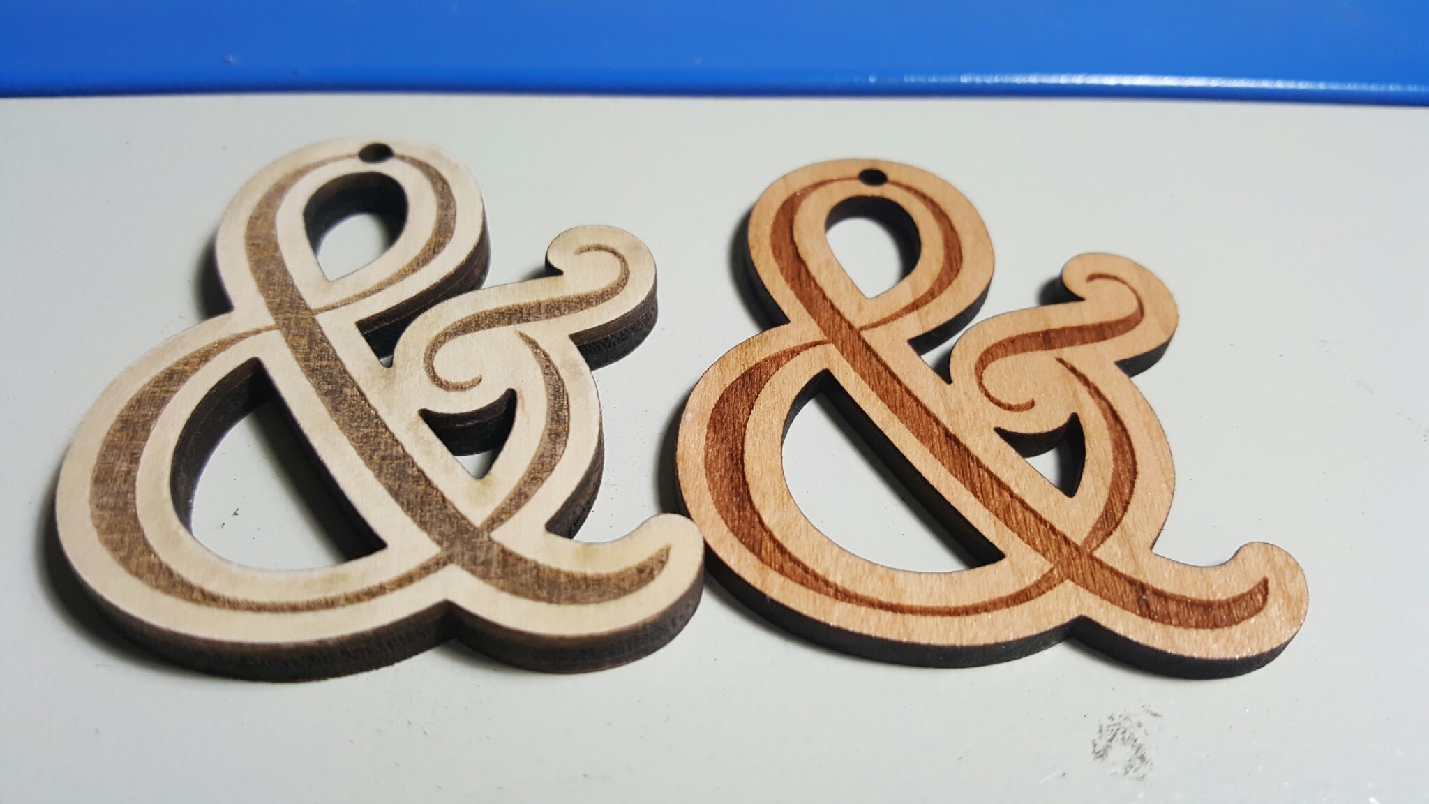

I’m working on a custom order and offered to try to engrave the back. Well, as you can see, it worked out perfectly. I cut 15 keychains on a 12" x 6" x 1/8" piece of cherry. I’ll be finishing the order this weekend (making 30 more) and I’ll make a video showing how I was able to line up the engraving on the back. The keychains are about 2.25" tall so the text has to be pretty well lined up to look good. It was easier to do than I thought.

Nice. But is the 1/8" wood thick enough to prevent the scrolled “tails” from breaking?
Looks good. A thought on Jim’s mention of the tails possibly breaking, you could fillet the corners a little (like with 3D printing) to reinforce the corners attaching the tail. So instead of sharp corners, they would be rounded out with a small radius (adding extra resistance to breaking at that point).

@Yuusuf_Sallahuddin_Y I bent and twisted them a little and while they didn’t break I wasn’t happy with how they felt. I redid them in 5mm plywood and they are very sturdy now. They’re not as pretty as the cherry wood but they’re durable. Thanks for bringing this up.
You sometimes have to consider grain direction for stability on some designs especially with thin stock. So in this case you could try the grain going the other direction which would strengthen the tail. However that would weaken the top loop so it’s a trade off sometimes.
@Jeff_Johnson You’re right that the 5mm plywood versions don’t look as pretty as the cherry wood. You could maybe consider doing something similar with stain (for non-engrave areas)/black (for engrave areas) like @Nedman has recently done on some wonderful pieces.
Thanks @Yuusuf_Sallahuddin_Y but I actually got the idea for the stain from something that Jeff had done earlier.
