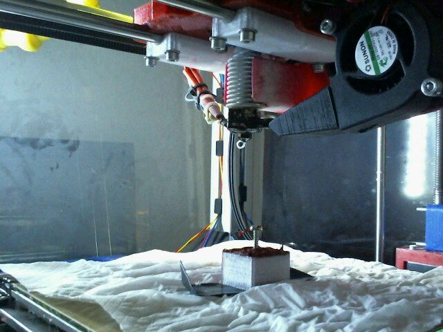

Downloaded a mold for e3d hotend (silicone) to isolate it.
Downloaded a mold for e3d hotend (silicone) to isolate it. Now trying to harden it faster with watervapor and heat xD any suggestions on how to do it better? Its 350deg celsius rated silicone but cant find silicone thats more runny to easier mold it…
