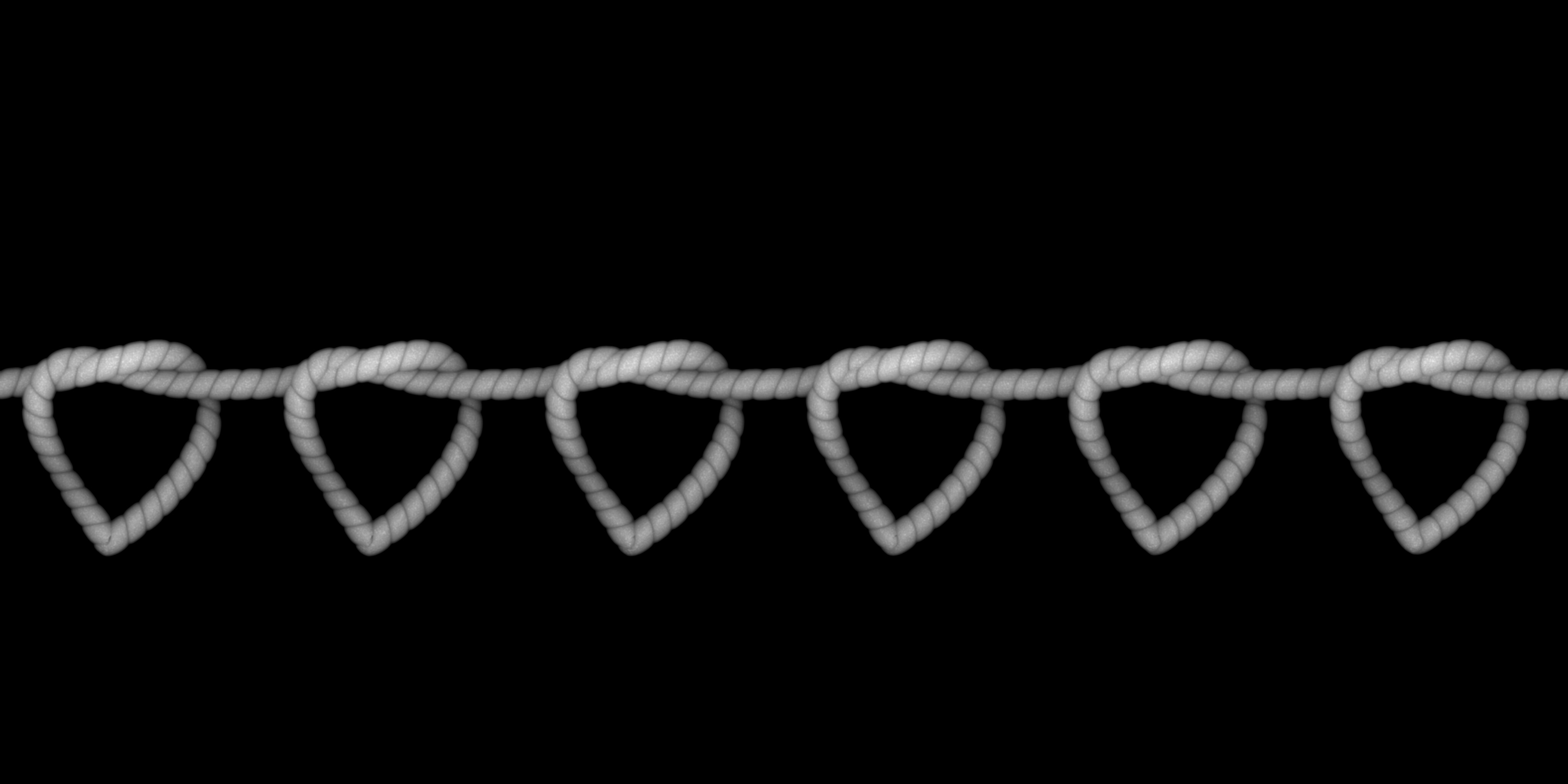

For the last week I’ve been playing with rope designs. I work in 3d so a little different but also similar.
Model one segment, create and array and then follow a curve (modifier).
example:
