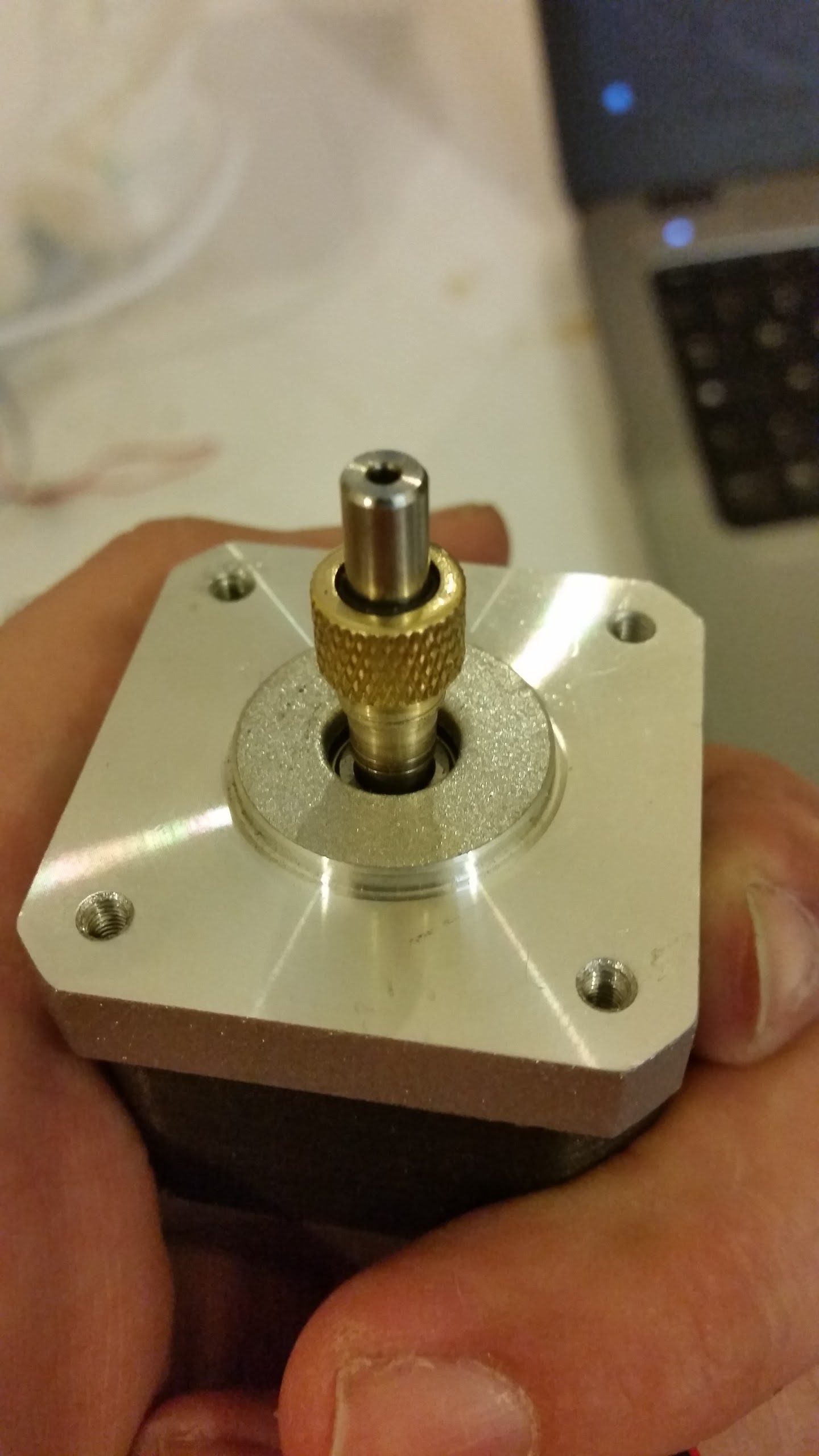

Now only need print correct size saint and try . I’m try to make it hot and enlarge it but without successes fast drill with 5 mm bit no enlarge to much and fit it with bench vice.

@Mauro_Manco Maybe try to put your stepper in the freezer (in a ziplock bag to avoid condensation). Using too high mechanical force can’t be good for bearings…
Difference too much Michael 5.1 stepper and 4.7 Presta adapter. fast drill with dot 5 not make any issue and hard support on stepper. (surely for remove need kill myself but hope work as i think) can confirm mk8 version on nema 17 possible work with this diameter? i need learn onshape/solidworks

MK8 version was done with a 10.68 OD diameter in mind. If, for any reason, it doesn’t work as intended, let me know.
