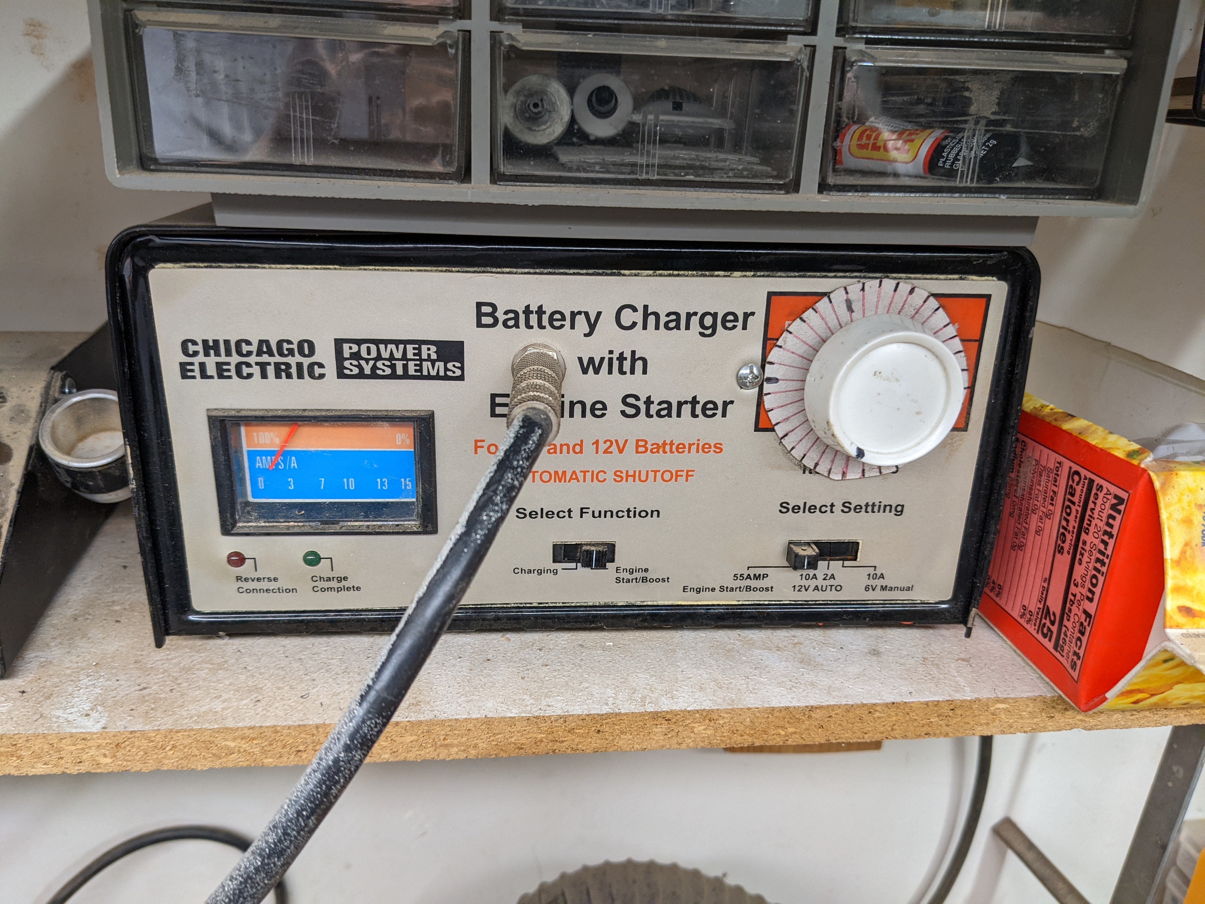

This is the power supply, a HF battery charger. You can use any DC source but you can often find battery chargers in the junk or thrift store. You need to ensure that the voltage and hot wire you use will give you the current and therefore the heat you need.
It has been modified with a 1/4 phone plug for power and a dimmer switch. If I was to do this again I would use solar charge connectors https://amzn.to/3BoFjoL.
The knob to the right is a dimmer switch that is connected to the primary of the transformer and adjusts the current as well as turns the unit on/off.
I always set this to the max so this control is probably only necessary if you have currents above 10-12 amps?

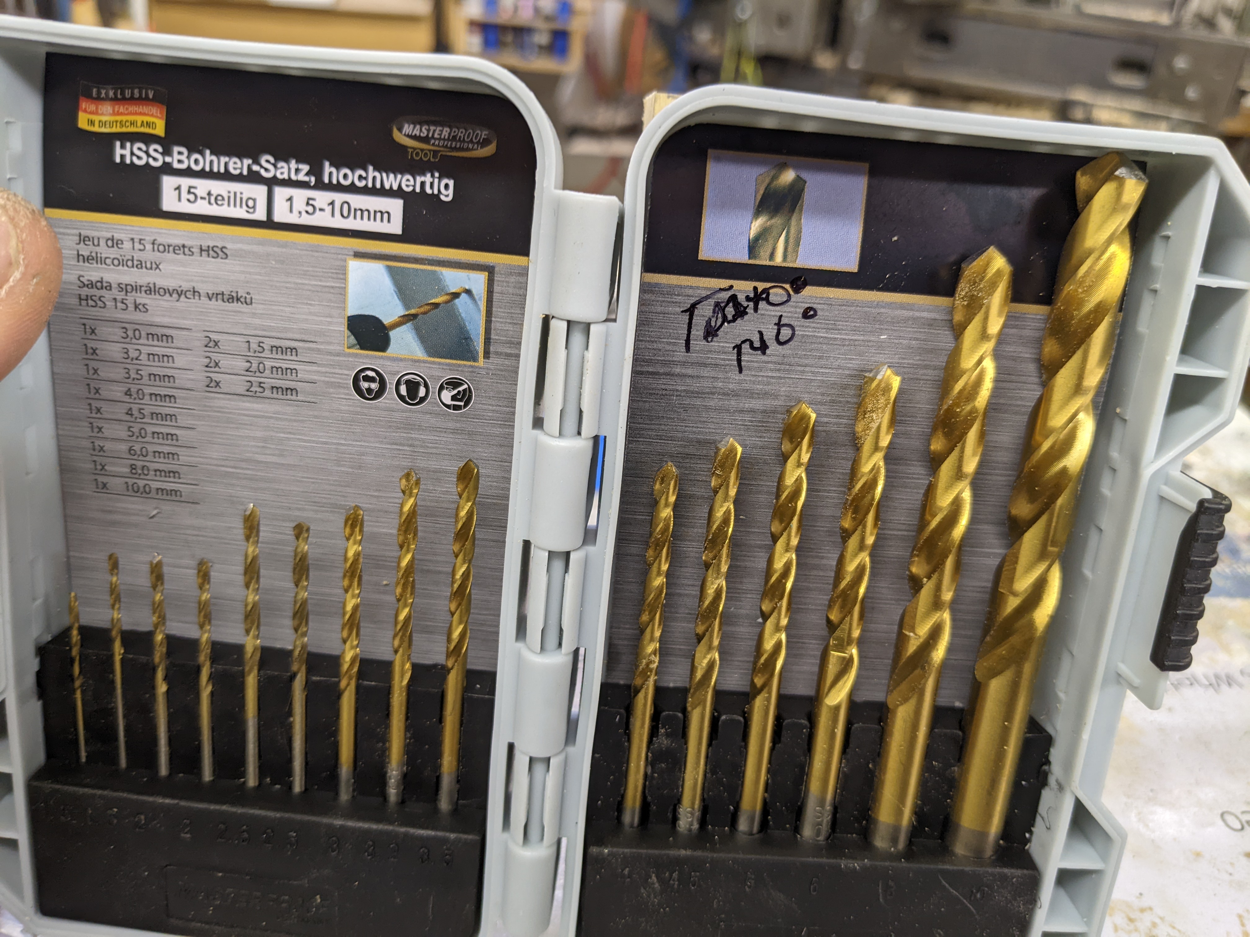

I bought a cheap drill index to resharpen for plastic drilling.
Note: I did not pay attention to the description, I wanted SAE bits and saw those dimensions in the description, these are metric bits which are SAE equivalents …NOT!
So I now have metric size plastic bits. I will order a SAE set … and pay attention this time.

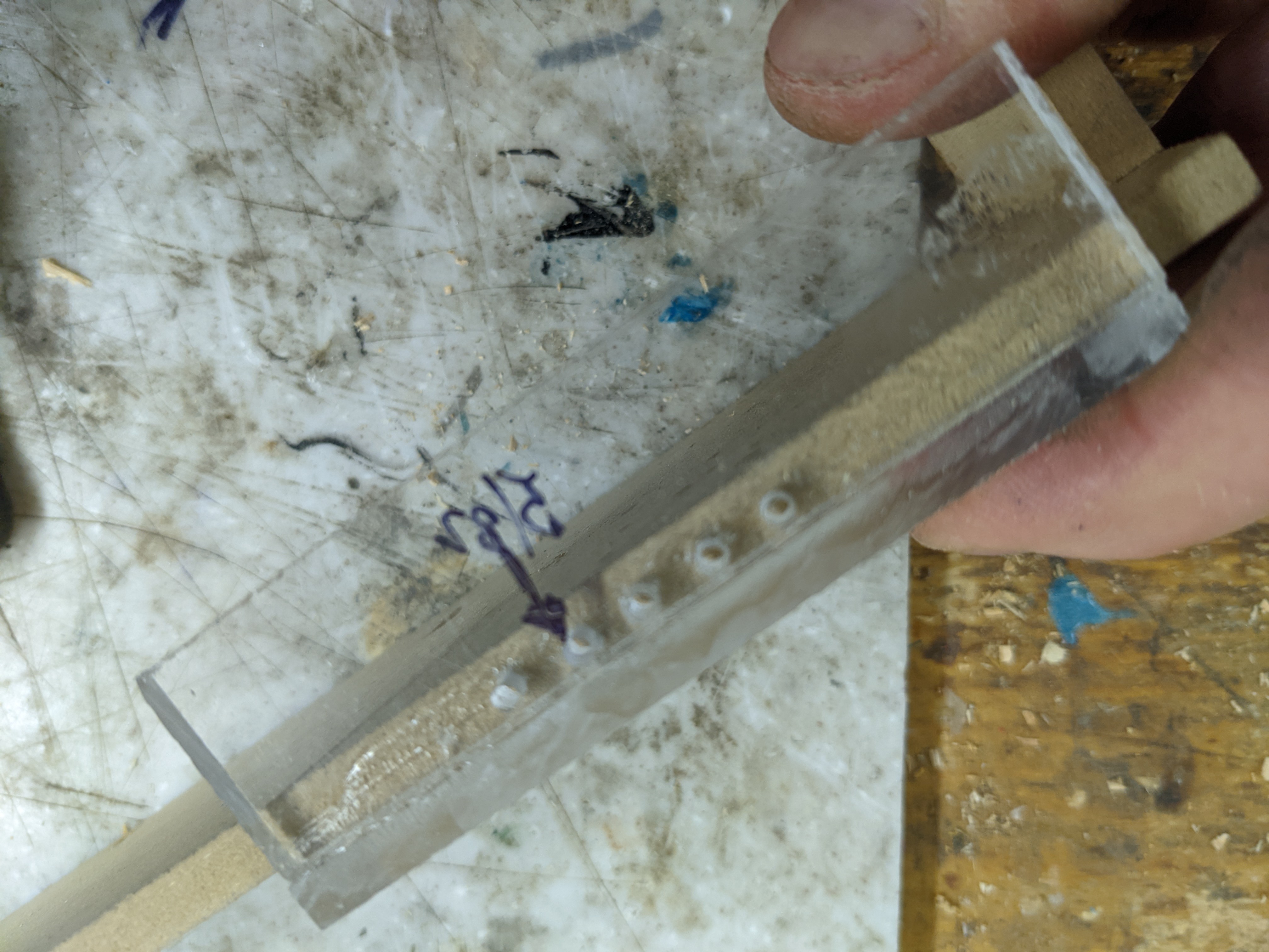

    The top 3 large holes were done with conventional bits using a slow pecking motion. Notice the melting of the side walls
    The smooth-sided holes were done with the modified bits. The hole with breakout did not have a backing board.
    You could tell that they cut better as curly plastic shavings exited the hole vs blobs of melted plastic sticking to the bit. I also did not notice the bit grabbing with the largest holes.
  2. You can still get breakout at the bottom of the hole if you put a lot of force on the bit or do not use a backing board. The smaller the bit the less trouble it had drilling without breakout. You only need enough force to let the bit cut and breakout is a thing of the past.
