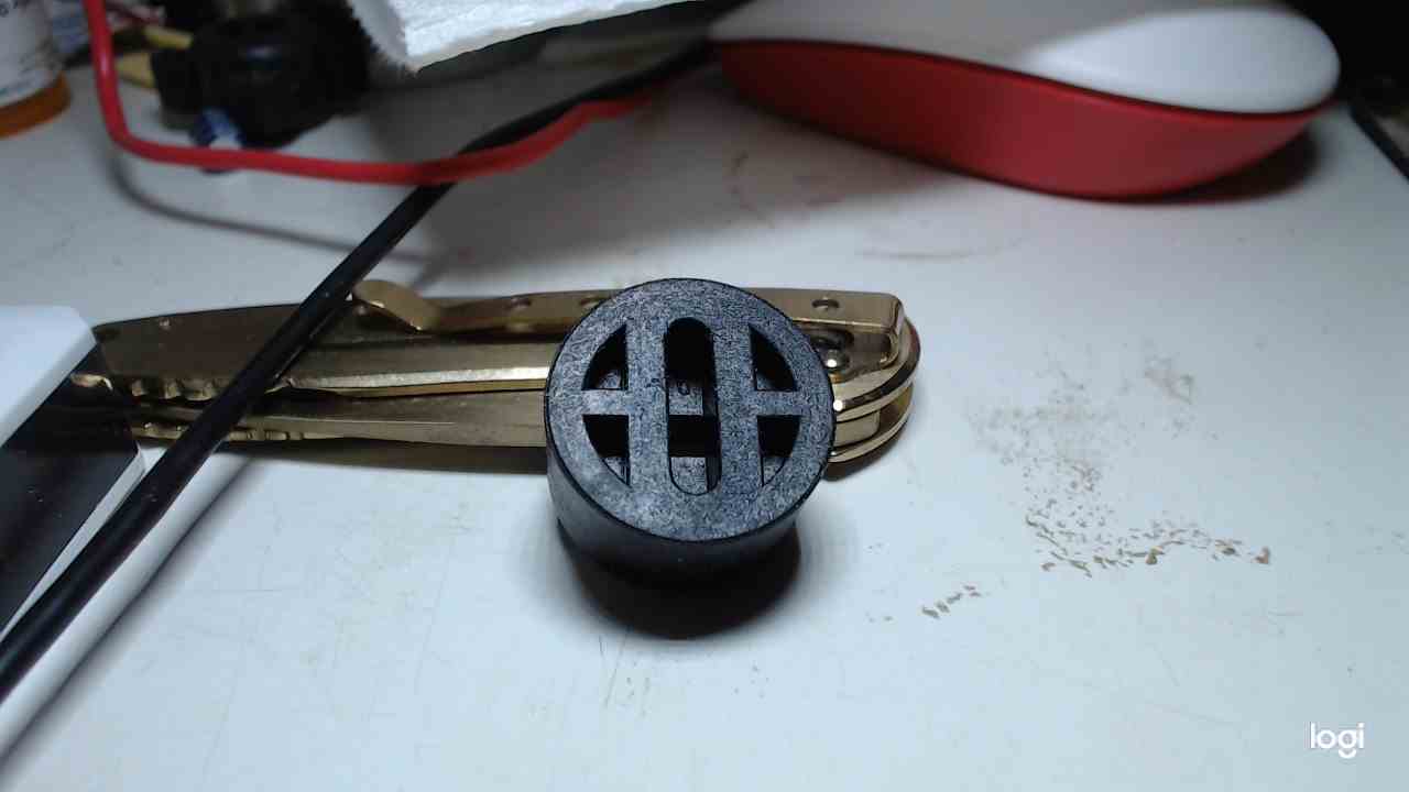

Hello, I have a Quantum MOT154323-01 electric wheelchair motor with a gear box attached. the connection between the motor and the gearbox has a ABS plastic coupler. I want to attach a belt pully to it and have never come across this shaped drive shaft. does anyone know what this is called. ie slotted or T-shape? someone making robots has to have come across this.
thanks in advance for any advise the shaft diam. is 12mm and the slot is 4mm wide
I am not positive what it is called perhaps a form of OLDHAM coupler.

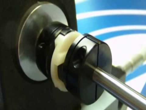

https://www.ruland.com/servo-couplings/oldham-couplings/oldham-disks.html
Found this through random googling. But now googling “tang coupling” isn’t coming up with much else (note: pic shows wrong end).

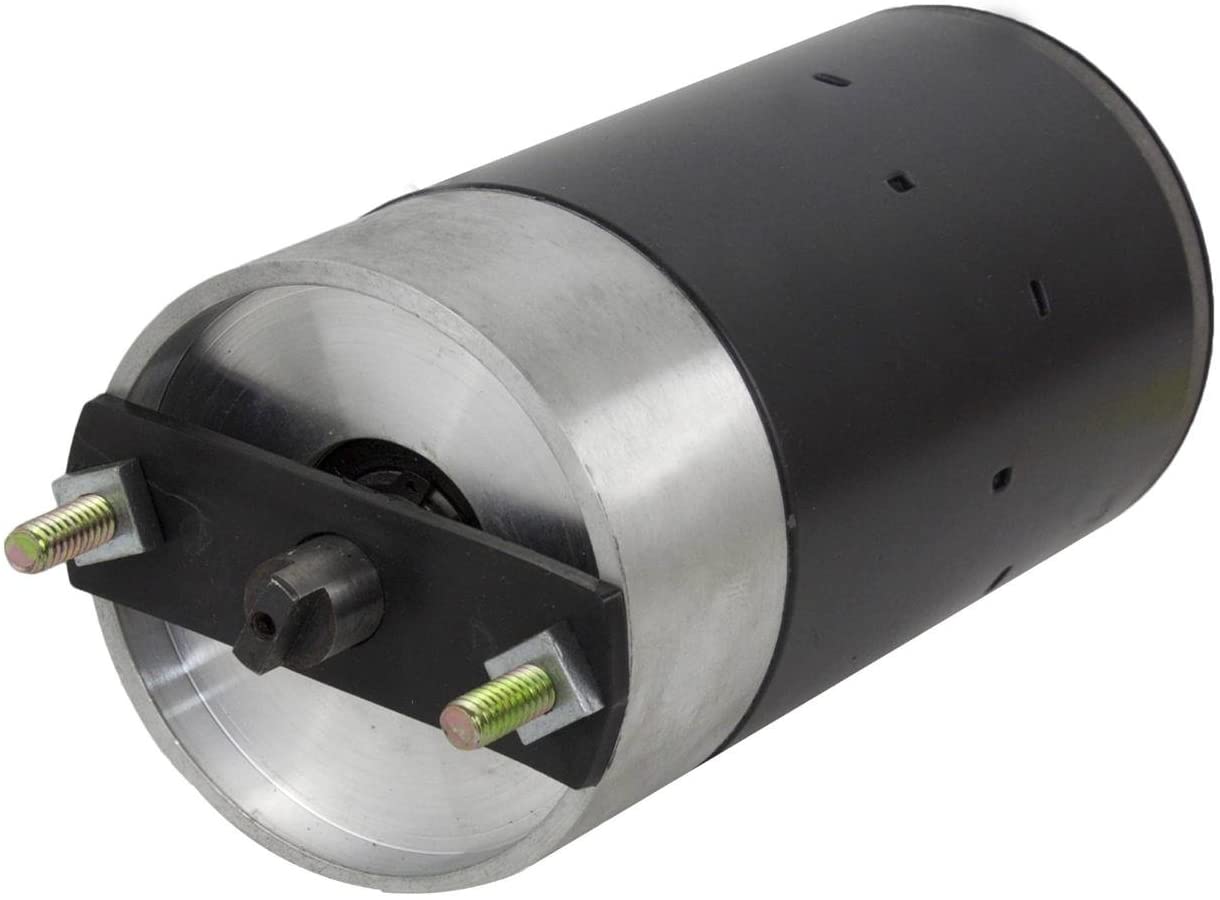

Also this on a motor:
OMG! I love that site. thank you for the help. It definitely looks like it could be an oldham style. Or perhaps a tang type shaft. as @TwelveFoot found.
