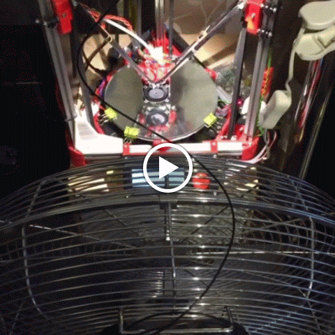

Dropping the speed and temp right down didn't help so I thought I'd bring
Dropping the speed and temp right down didn’t help so I thought I’d bring in some extreme cooling. Only to find the chill factor caused the print to lift off the bed!
Time to turn up the bed temp a bit and try yet another test… yawn… this is getting tedious. No wonder some printer suppliers lock users into their filament and carefully mix chemicals so they all have the same temperature requirements.

This fan was too extreeme, the bed wattage wasn’t high enough to keep the bed warm even on the fans lowest setting. Time to dig out some PC fans.
