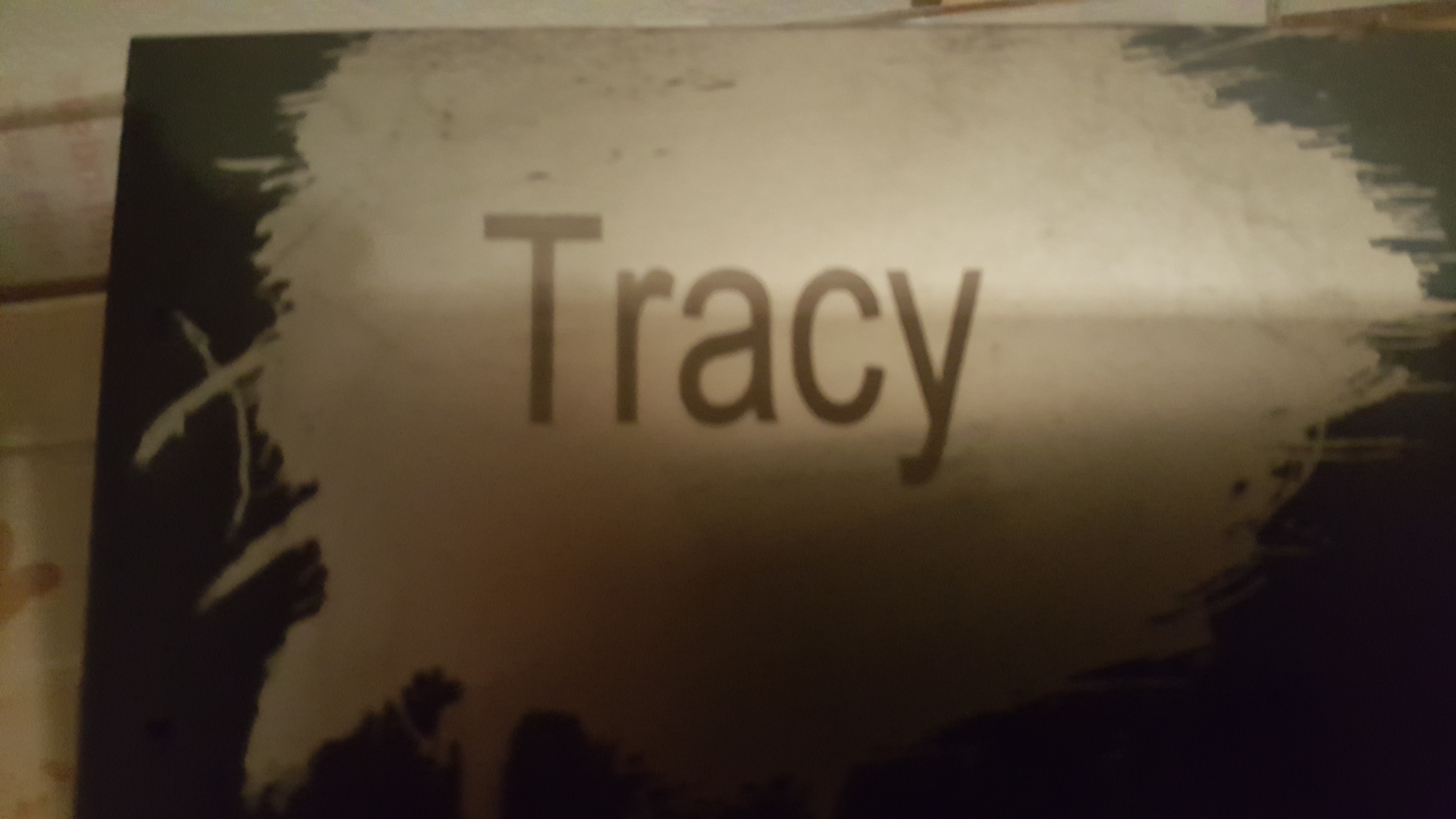

Dry moly lube spray on stainless…can’t get it to come off with steel wool…lol

So has all the black region in the background been lased as well? Or just the word Tracy? Looks very crisp on the writing.
@Yuusuf_Sallahuddin_Y …just the word tracy…this was my first test…the rest is just where I sprayed the whole sheet of stainless.

I made some tests using the same stuff a while back. Try using acetone or alcohol to clean it after you engrave.
@Coherent …good tip bro…I’ll pick some acetone up today
I think what worked well for me was actually isopropyl alcohol and elbow grease. It’s been a bit and I tested a few things. Either one is also great for cleaning before you spray the moly on also and acetone evaporates fast.
What was the power level/speed?
I’ve been trying it on SS & Aluminum, but I find that it isn’t really bonded well – cleaning with a nylon brush removes it if you’re not careful.
I also tried chrome, but I expected that to not work…
@Thor_Johnson …50 speed…60%power
