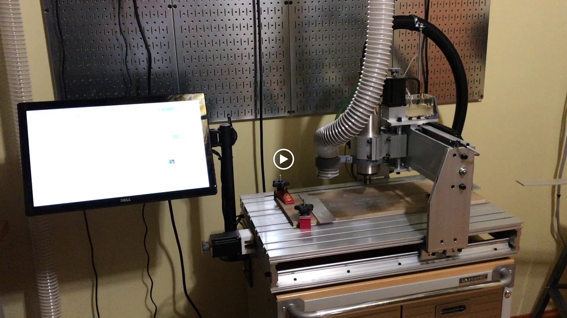

Dry run of my workspace (including new 3dviewer). All running on a raspberry pi 3… yes, both json server AND the web interface on a single pi3!

@Daniel_Chote whats your pi3 configuration to display the 3D view? I can’t get this to work on my pi3 / stretch / chromium setup.
@Loop_Masta be sure to enable gpu acceleration using the pi config tool. That should be the only thing extra you need to do
Thanks @Daniel_Chote . I set the raspi-config/Advanced Options/GL Driver to G1(Full KMS) and set the chrome://flags to webGl enabled but it still doesn’t work.
@Loop_Masta that’s all I did. Make sure that Xorg is using acceleration.
@Daniel_Chote You appear to have accomplished what I’m trying to accomplish…I’d like to be sure that my assumption is right…
I already have the modeling through gcode generation working, and I’m happy with it. I already have an Uno running grbl, attached to a gShield v5b, attached to my mill. I’m happy with that.
I want to use a Ras Pi 3 to replace any laptop/PC in the tool chain once the gcode has been generated. This means that the Ras Pi has to manage homing, jogging and sending the gcode to the grbl Uno. I am not adding anything new to the tool chain, simply replacing a “full-fledged” PC or laptop with the Ras Pi.
If I am successful, I can connect power, K, V and M to the Ras Pi, download a gcode file and load material and run the mill completely independent of anything else.
As an option, and only as an option, I want to be able to omit K, V, M and RDP into the Ras Pi from a laptop and machine a part, free to disconnect the RDP session at any time during the machining process.
Am I correct that this is what you’ve accomplished?
If I am correct, can I pick your brain so that we can fully document the process from day one and share it with others?
@Michael_Hendricks yeah. The trick is to be bare bones. I’ve been meaning to write a post about it. You can pretty much follow along with my octopi web setup on a pi3, on how to get chromium working on a minimal install http://projectable.me/raspberry-pi-touchscreen-octoprint-controller/

@Michael_Hendricks there really is only 2 things to do with chromium. Install it, and setup systemd startup. You can edit the systemd file to load with a different URL. All the other stuff preceding octoprint setup is x11 setup, which is needed for anything like this

@Michael_Hendricks as for chilipeppr running entirely on a pi, I wouldn’t endorse it as something everyone should do. It “works”… big jobs will kill it, simple 2.5D jobs are fine. Chromium will constantly complain about the page being “dead” when it’s not. It works for me, because I know the limitations. But I’m all honesty, I’m debating writing my own stack, optimized for the pi. Or maybe going the linuxcnc route.
