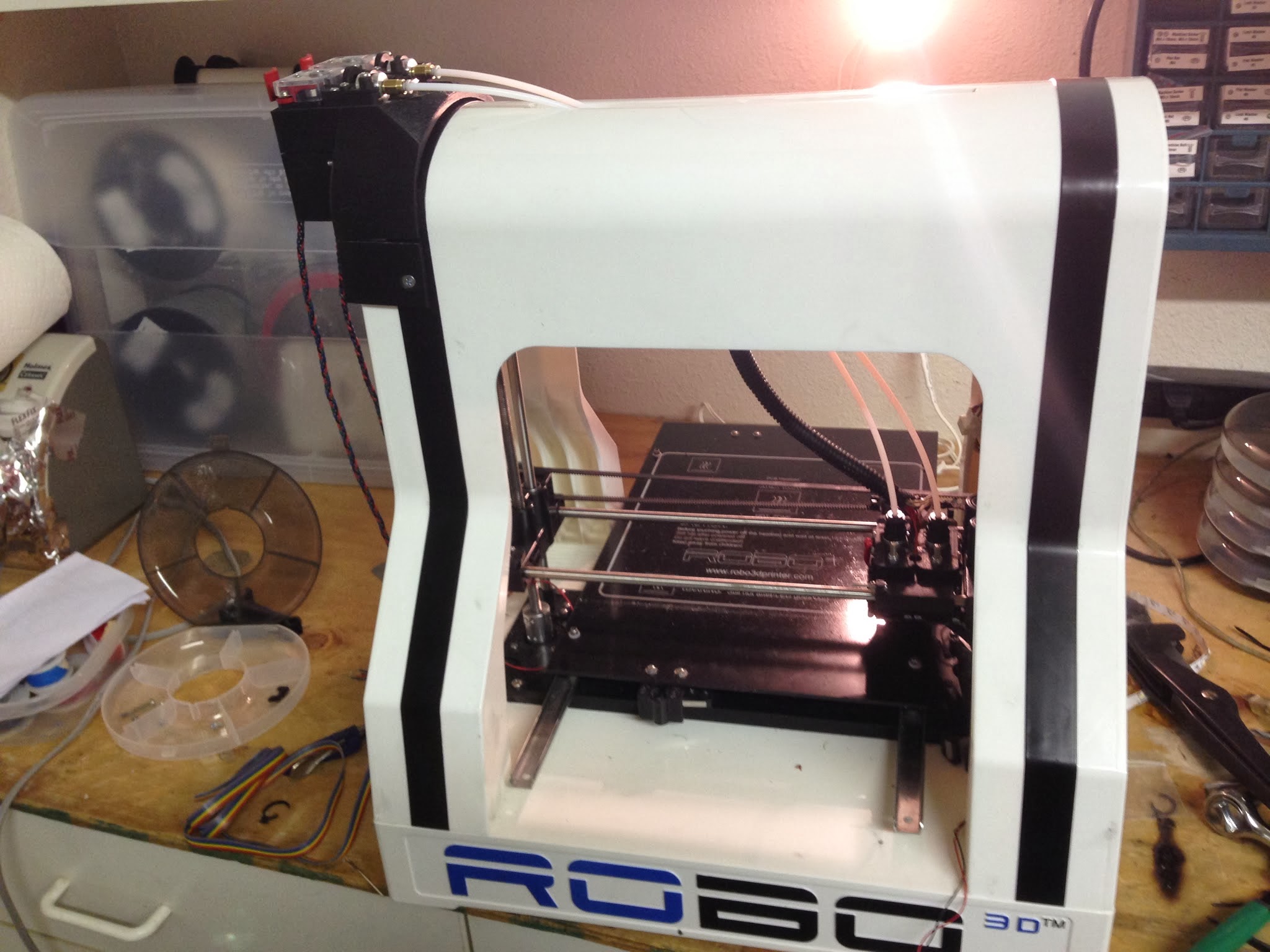

Dual Bowden Extruders for the Robo 3D printer is coming along but I hit
Dual Bowden Extruders for the Robo 3D printer is coming along but I hit a major roadblock.
Edit: It turned out to be stupidly obvious. The ramps board is missing the stepper driver for E1. You can read below if you want to see how I set it up.
E1 on my ramps 1.4 board is not responding to software requests.
I’ve determined E1 is indeed the issue as I’ve connected both extruder motors to E0 and they both would extrude properly. Neither responded on E1.

Um. Have you got a thermistor and hot end wired up to the relevant ports on the board? The extruder won’t move if the E1 temp is bellow your min temp set in marlin. Set your min temp to 0 to temporarily overcome this.
@Tim_Rastall Yup both hot ends work great.
I’ve actually solved the issue. The ramps board that came with my printer does not have a driver for E1. Kinda of a stupidly obvious solution, but something I didn’t even consider last night.
Hah. Good you solved it :smiley:
