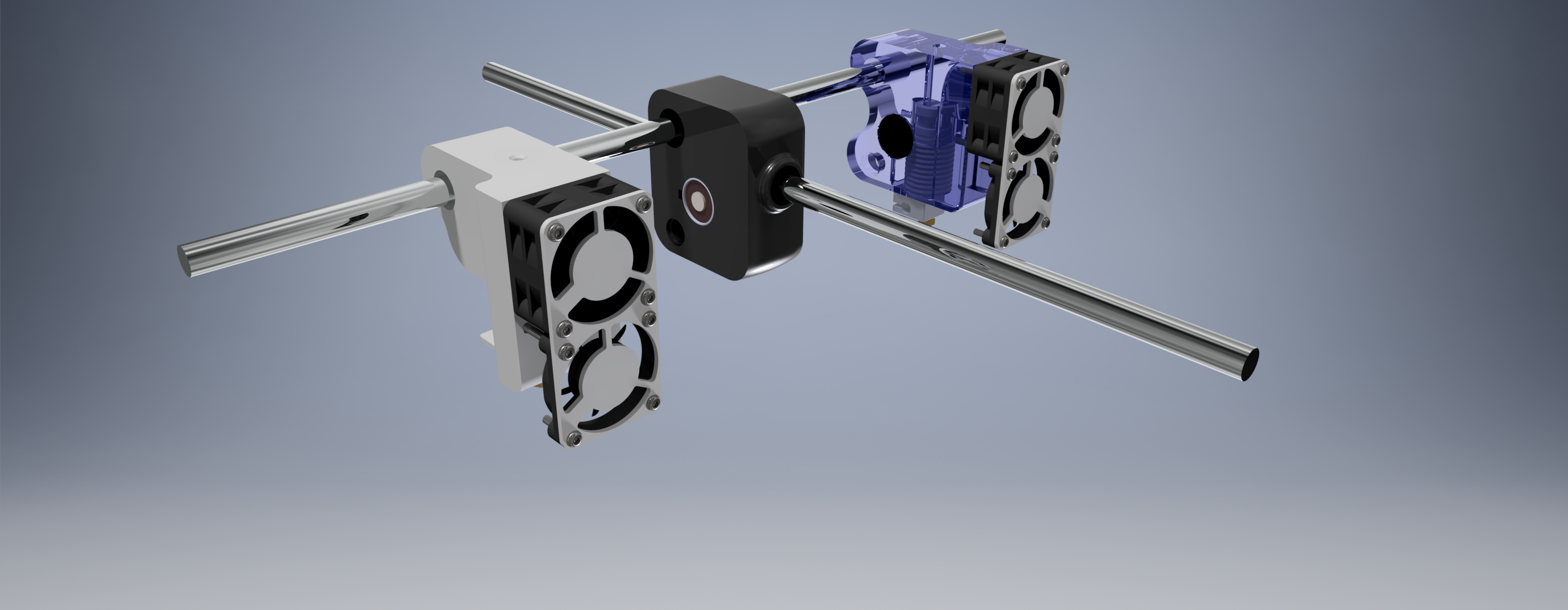

I’m tempted to go with the tool changer but I found this:
Something similar could be done on the eustathios. The weight is still there but only in Y.

I started working on this.
