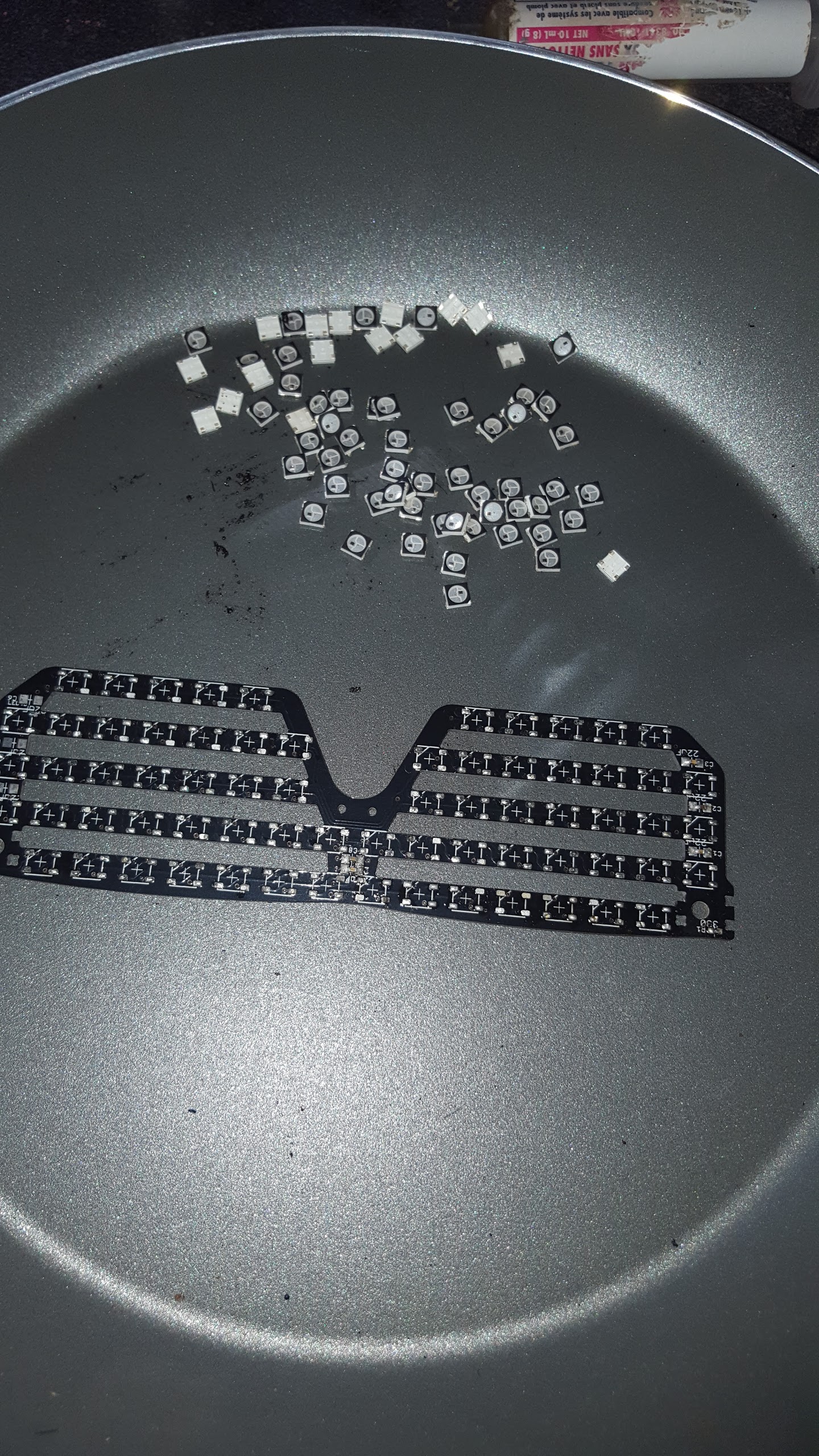

Are you reflow soldering on your stove?! What the heck is that photo showing @Cristian_Martinez ?
Oh yeah thats where i do all my reflow soldering. I still need to 3D print the stencil thou but this is just the PCB and the LEDs. I attempted to hand solder them but it wasnt looking right so i took it all appart and cleaned it up. Ill give it a shot once i get some new solder paste as mine has turned from paste to concrete even thou it was stored in its original container. Not sure what happened lol

@marmil how do you do your reflow soldering?
I still poke at stuff with a hot stick until I accidently fuse something together. I’ve never tried reflow soldering. Was under the impression you needed an oven with a special temperature control.
Nah man ive been reflow soldering on my stove since last year. Just get the low temp solder paste. 138C i set my stuff to #6 and you can see when it starts to melt and grab all the pieces. Thats a good time to cut the stove off. Itll stay hot enough for small adjustments but if you let it sit there too long with the stove on the solder mask at the bottom will begin to melt and it will not end well. I speak from experience. I couldnt get the stench out of my house or my nose for days lol
Electrix stove? I could see how it would stay hot for a bit after you turn it off. A gas stove would cool too fast with that thin skillet…
You definitely need low temp paste to make sure the LEDs don’t overheat (they die quickly if they ever get too hot). Your PCB looks pretty good, the notches in the corners for the hinge pieces can be hard for PCB manufacturers to get right!
@Garrett_Mace hey Garrett :slight_smile: yeah this was done by PCBway. Only PCB manufacturer i use :slight_smile:
