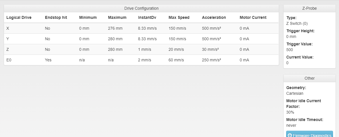

What version of RRF are you using? I am on 2.04.
Speeds and Accelerations and Jerk are what I have been trying to tune.
The delta guys numbers are too aggressive, the CoreXY guys are better, but again too fast for my liking.
Here is my summary - I am posting from DWC instead of the params as it might be more readable.

See here. I’m not pushing for max speed, but have been using these for quite some time without changes. Extruder 1 is a Bondtech QR, Extruder 2 Titan. I’m using bigger motors with a 2:1 ration, cause I earlier had some issues on Smoothie, but since I’ve moved to the Duet it’s got much better.
