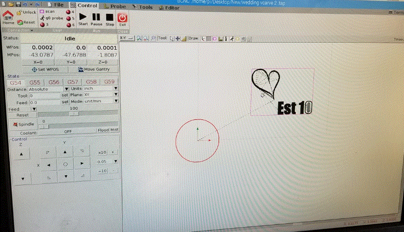

It sure why it is not pulling in the whole design in bcnc… the perimeter cut pulls in the design, but for some reason every time I try to vcarve sections are missing… any idea why? It looks like it cuts off at the margin box and I cannot figure out why.
Maybe the details are too small to cut/carve/mill?
@Mano_Biletsky_Open_M it was that the bcnc time out was set to 5… If you change it to inf.
