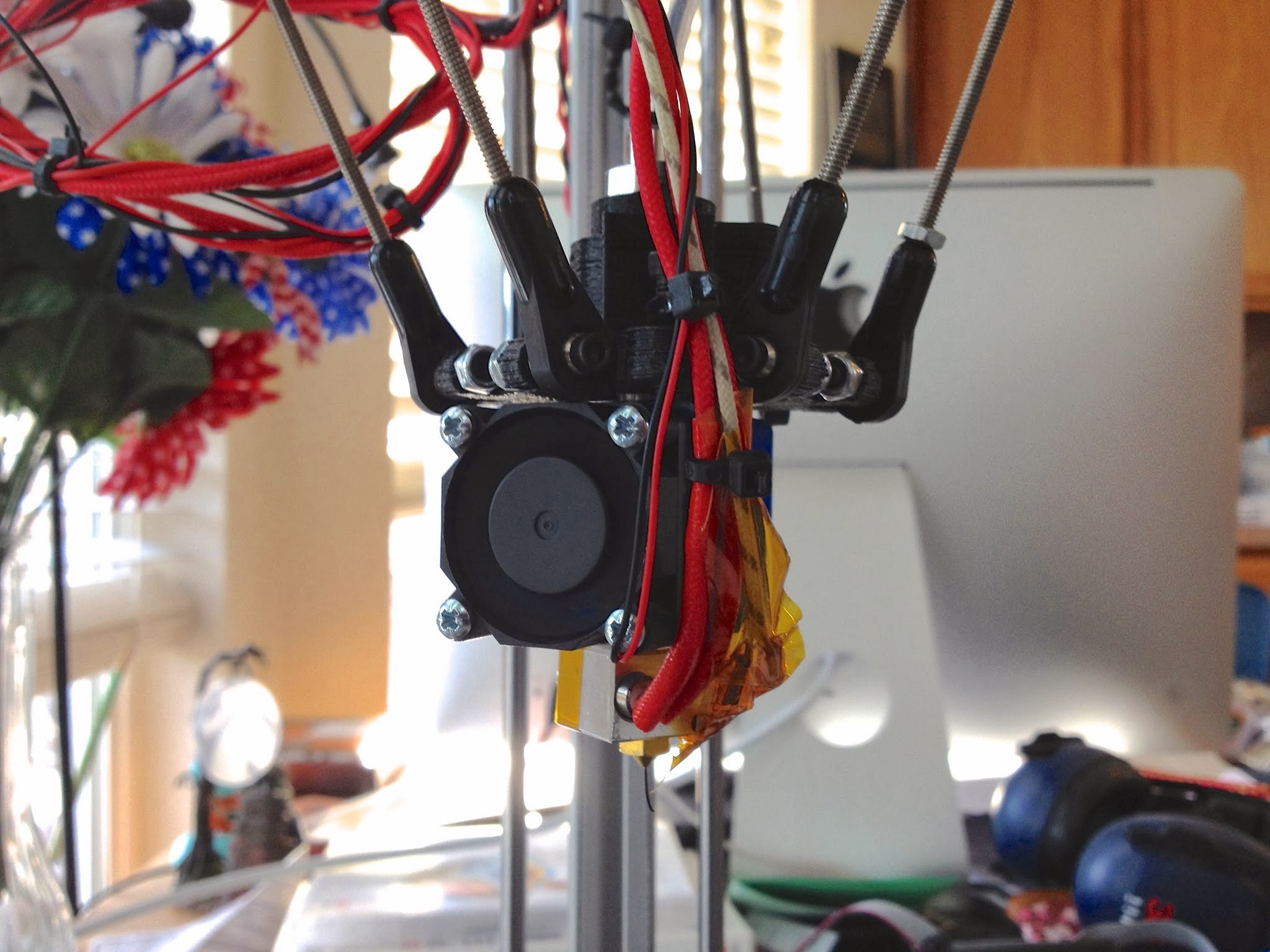

Got a package in the mail! Spent the evening assembling, then rolled up my sleeves to print some plastic! Calibrated the envelope, ran the self-calibration tests, and went to make a print!!! (It’s been a long wait to get back here.)
Looking at the temp, I suspect the constantly on fan is keeping the system from reaching equilibrium…anyone have an e3d in a 3DR? What’d you use for calibration? I figured out why they tell you to have it always on (the motor doesn’t like PCM), and it’s a helluva improvement over my aborted attempts…so how do I get past this?

1 is working much better. Now I’m back to my original first layer and Bowden problems.
Try insulating the metal of your hot end. Qu-bd has some ceramic tape insulation for pretty cheap that I bought for the same reason. Be sure to use plenty of laptop tape to hold it on as mine got ripped off a handful of times.
I have a wrap of ‘self fusing’ or self vulcanizing tape around my hot end. Its rated for 260 C. @nop_head has blogged about it. I did it to make sure the thermistor stayed put ! Glad to hear you are past the hot end issues.
