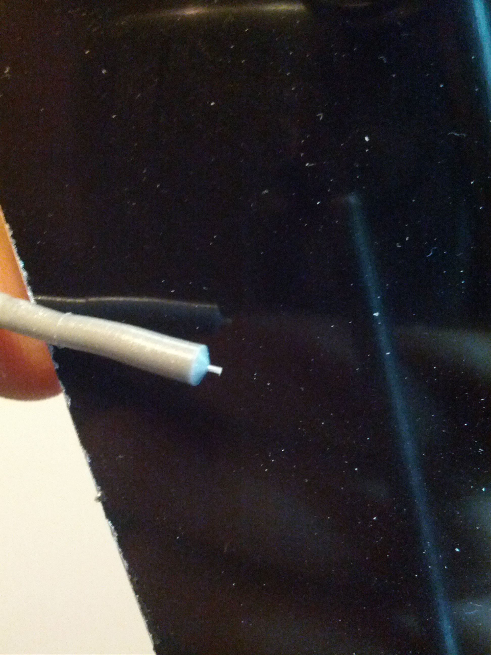

ABS, silver (JET from Amazon), at 220 C, default print speeds + a few mm/sec, 0.3mm layer height. Printed simultaneously. The picture of the filament I pulled out at one point during setup demonstrates the small transition zone and tight accuracy of the internal machining.
