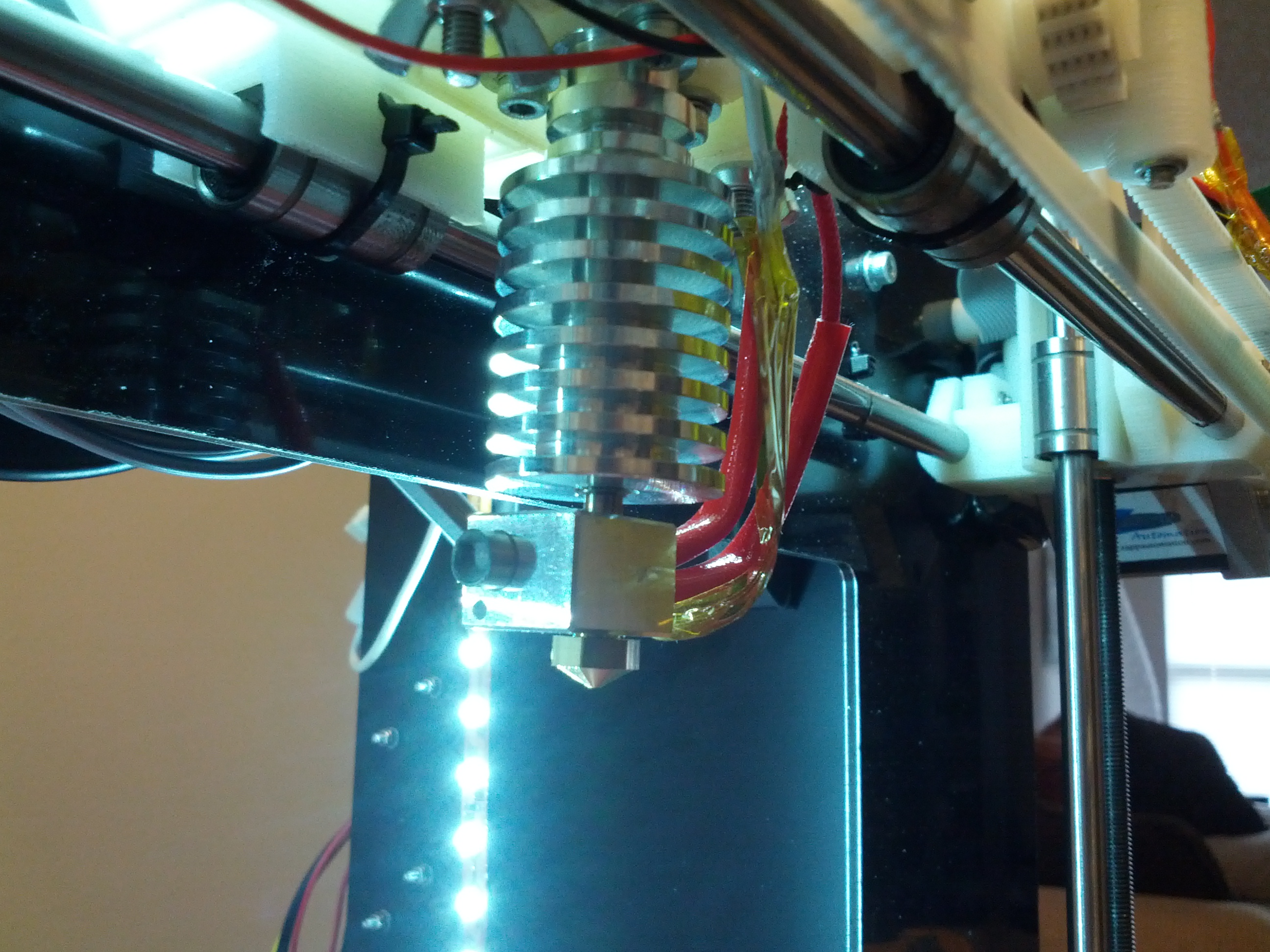

E3D-Online extruder in! Amazing piece of hardware - time to see how it prints.
E3D-Online extruder in! Amazing piece of hardware - time to see how it prints. The mendel 90 carriage mount meant for 6mm j-head is the right size, but the depth of the hole is to deep (the thickness of the great SS nozzle is a bit small.) Turns out, this doesn’t matter! When you drive filament into it, it pushes against the retaining washers and keeps it steady. @Sanjay_Mortimer Great job! Great price!
Where is the fan gone? BTW it looks good. :slight_smile:
It does, I took the fan off temporarily to show off the machining.
That is a thing of beauty. A Full Metal Hot End is certainly on my future buy list.
I’ve heard about it recently and also bought it right away a couple of days ago. Looking forward to get it running in my huge delta :slight_smile: Good to have @Sanjay_Mortimer right here on Google+ !
I’m printing a few “washers” of varying thickness with the work printer, as I can’t get a consistent Z-offset with the nozzle jiggling (turns out pressure from filament isn’t enough to steady it.) I’ve also noticed that the temperature control has a longer settling time - @Sanjay_Mortimer - would you have any PID recommended values associated with the cartridge heater / overall hotend? It seems pretty high performance (without looking at the spec sheet.) compared to the ceramic power resistors of the j-head style nozzles.

Only just tonight having enough time to dial in the settings (new z-offset) and PID. Melzi control board is being a bit temperamental too. I’ll post when I have the results!
About to post some pictures of the first parts (messing with z-height & temperature for the new nozzle.) Last step is runing the M303 command to tune the PID - but the print thats finishing up now looks like the nicest I’ve ever done on a rep rap. Crazy good!
