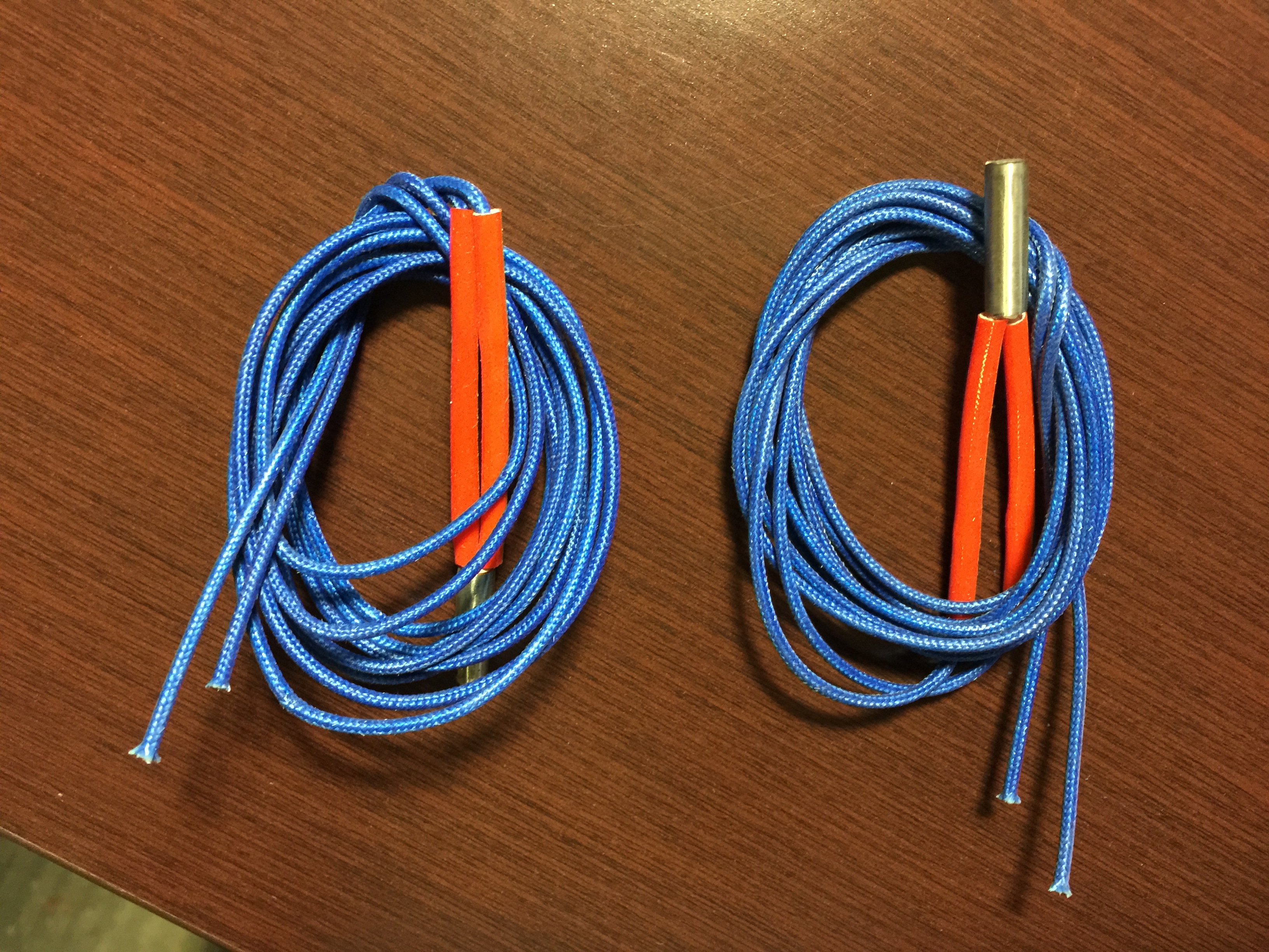

Are these the same? One has a resistance of 24 and the other 25.5.
Looking at this link under Heater Cartridge it mentions two different leads.

I’ve had them with slightly varying resistances too, I was never sure either. However, they gave very similar temps and heatup times when using the exact same marlin settings so I didn’t pay it much mind.
Are these the ones that came with the E3D? Than they’re probably only the 25W versions, you should think about using 40W ones.
@Helmi Yes they are. So I need to order the 40W leads then I take it?

You should be okay to start with the 25W but it will sure be not powerful enough if you go a bit faster. I’ve just put that aside before even testing it. Don’t know why they exchanged the 40W in the bundles with the 25W ones.

I ordered the 40W leads.
