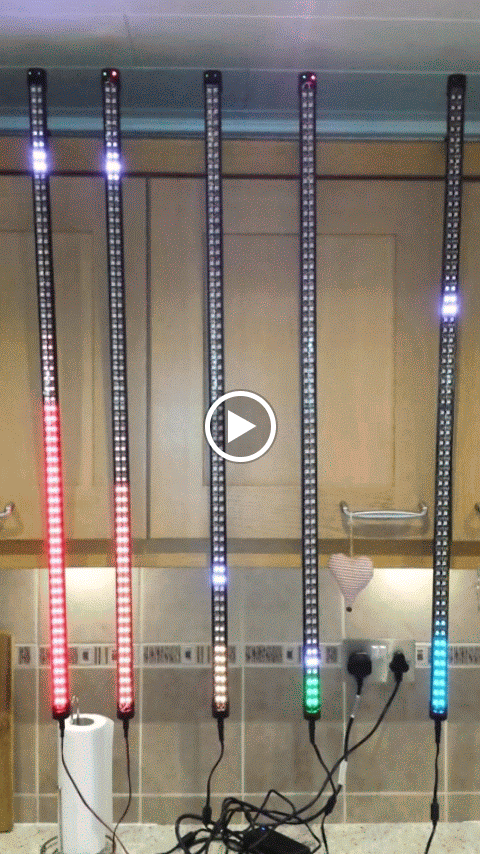

Each stick is a meter long with a built in Arduino Nano driving 2
Each stick is a meter long with a built in Arduino Nano driving 2 strips of WS2812 x60.
Communication is achieved wirelessly via NRF24L01.
This effect is obviously sound to light but there are many more stored effects that can be called up via an app I have made for my mobile phone.
I now have a total of 10 of these sticks which are great for parties or a backdrop on a stage.
Thanks for looking, Richard

@Richard_Everitt are you using MSGEQ7 or mics?
@Juergen_Bruegl Hi Juergen. Both actually, a mic with a pre amp that is then feed into a MSGEQ7.
This is then read by the base station and then transmitted via a NRF24L01 to all of the light sticks.
Each light stick uses the same code but has its own hard wired address so it knows which data to pick out and display.
Along with the sound data I send colour options, brightness, speed and effect number.
So far I have managed to pack in about 25 effects + options into the small memory.
The only cable that plugs into the light stick is the 5v power.
Thanks for your interest.
