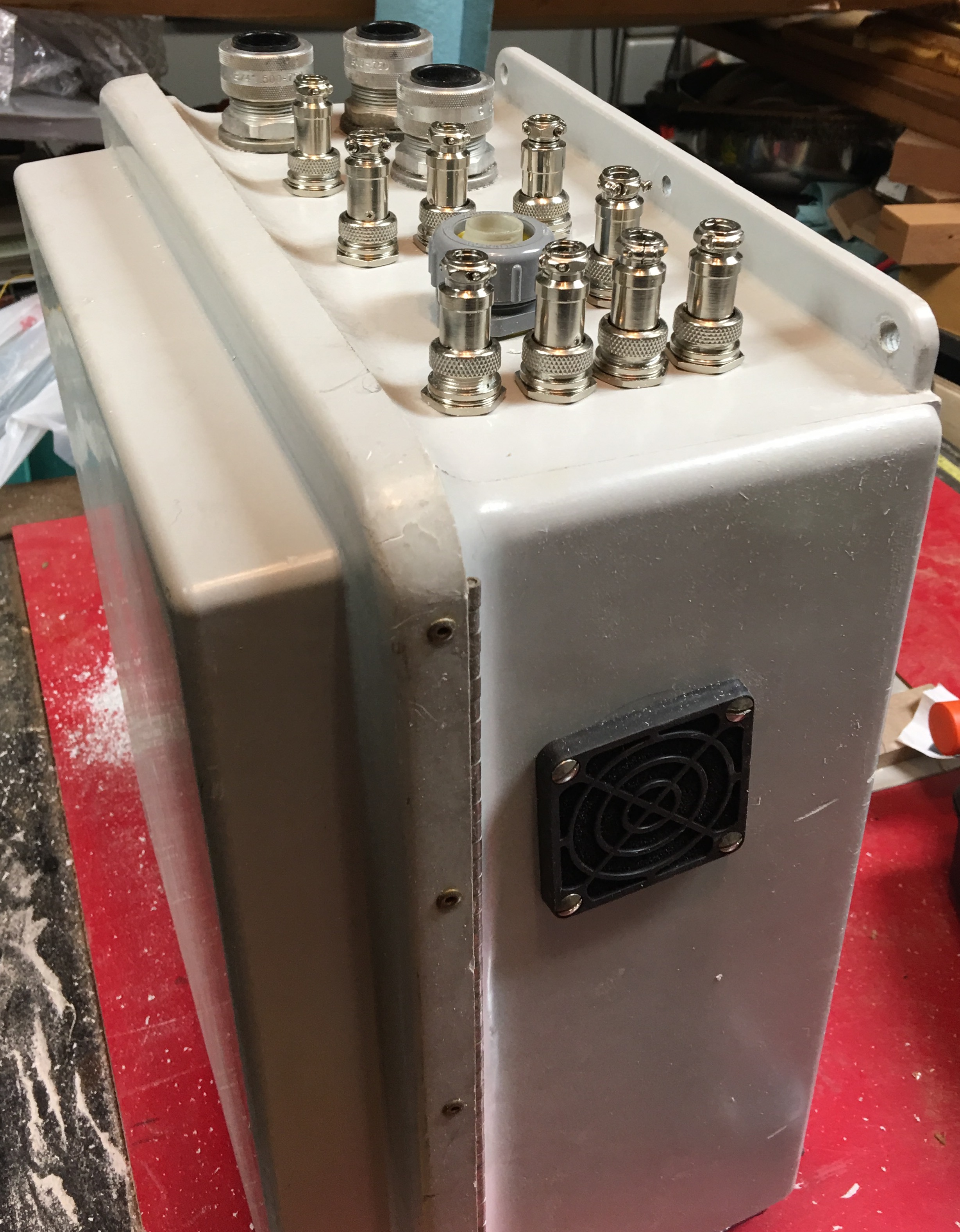

Early layout of my R7 control box. Still moving things around to try to optimize space and insure cooling inside this box. TinyG will have a fan blowing directly across the bottom heat pads and will leave room for a larger heatsink, if needed
The invert front panel will be detached and mounted on the front panel of the box. This will let me mount the inverter upside down so its fan will blow up.
