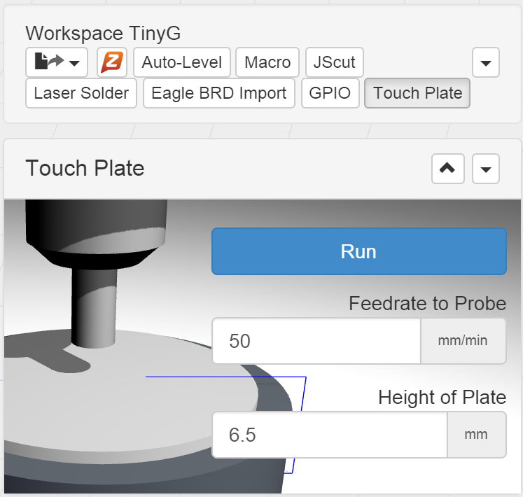

Easiest zero Z setting ever. Uses G38.2 to probe and G92 offset after probe is done to set zero taking into account your touch plate height, i.e. if using a PCB as your plate set the height to 1.75mm.

@Joshua_Pierce you should be able to run this fine on the tool change. Do your touch plate probe then just unpause the Gcode widget afterwards and you should be ok. The only thing that might be weird is i’m using G92, so if your Gcode overrides G92 then I could see a problem, but most Gcode does not use any G92 offsets inside it.
@Joshua_Pierce Hmm, u got me thinking here. I also set G21 and G90. I don’t un-set either of those intelligently. That could be worked in. Also, a machine coordinate change option could be added too instead of G92.
