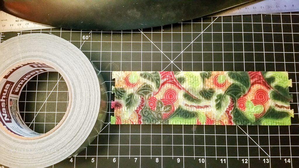

Easy mask removal with duct tape ...
Easy mask removal with duct tape … Remember, low tack tape on the piece, high tack tape to remove it.
What are you laser cutting. Did you put the design on, and how.?
I’m cutting exactly what you are seeing there. Sorry, I can’t tell you what they are yet, you’ll just have to guess. The design was engraved on, through the mask, then air brushed.
