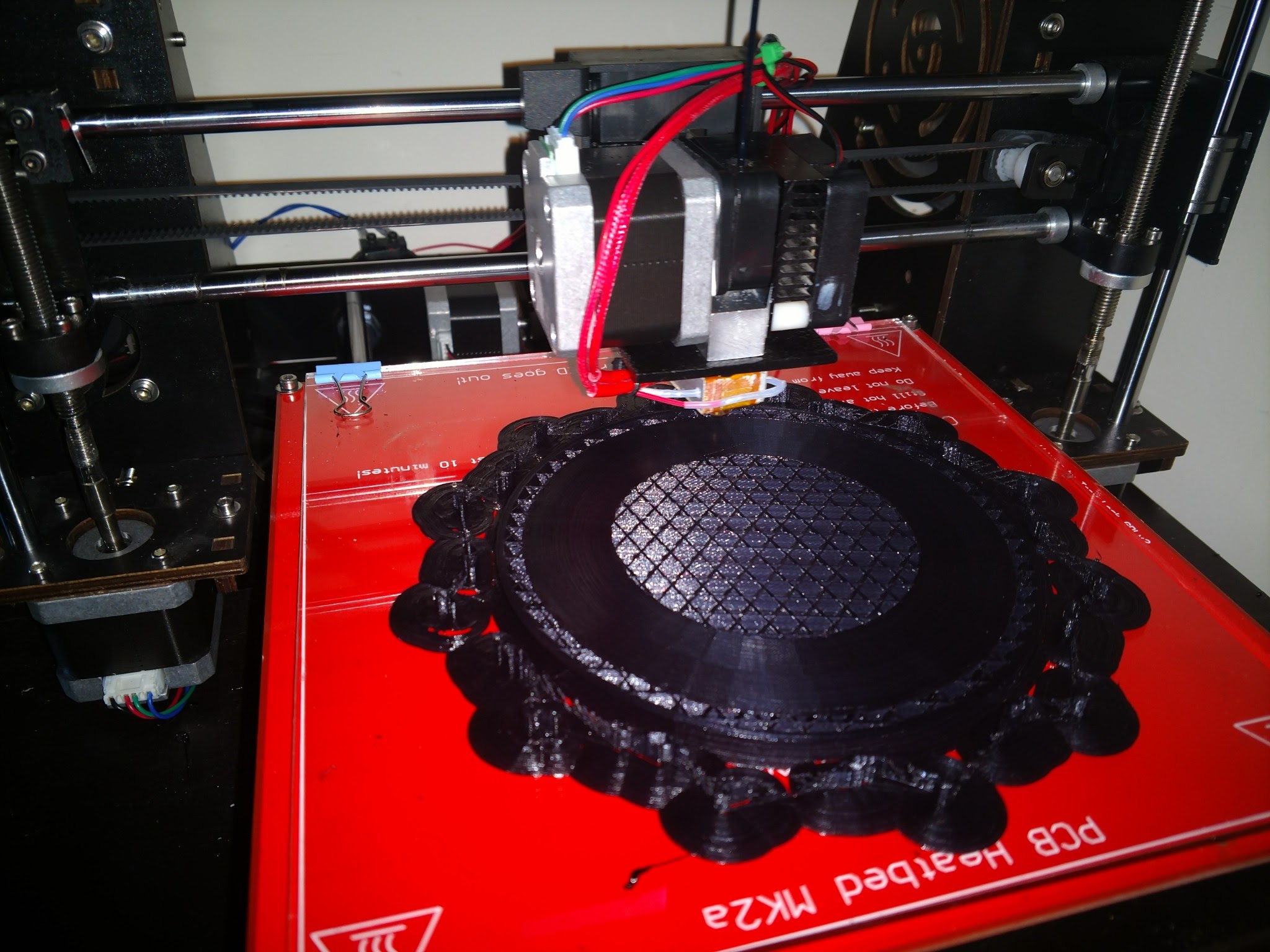

The start of a “56” hour print, my longest yet. Let’s see how it goes… Fingers crossed!
Just learn each other
@Vinh_Nguy_n what?
Good luck!
Best of luck.

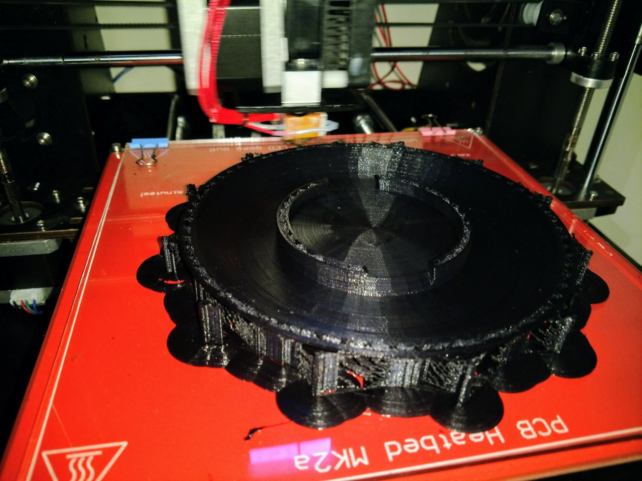

7… Hours… Later… Lol. I had to turn the speed up to 150%. It was going too damn slow.
13 hours in. I increased the print speed to 150% which should put it at about 45mm/s. Slowly but surely.
17.5 hours in. Looking good so far!

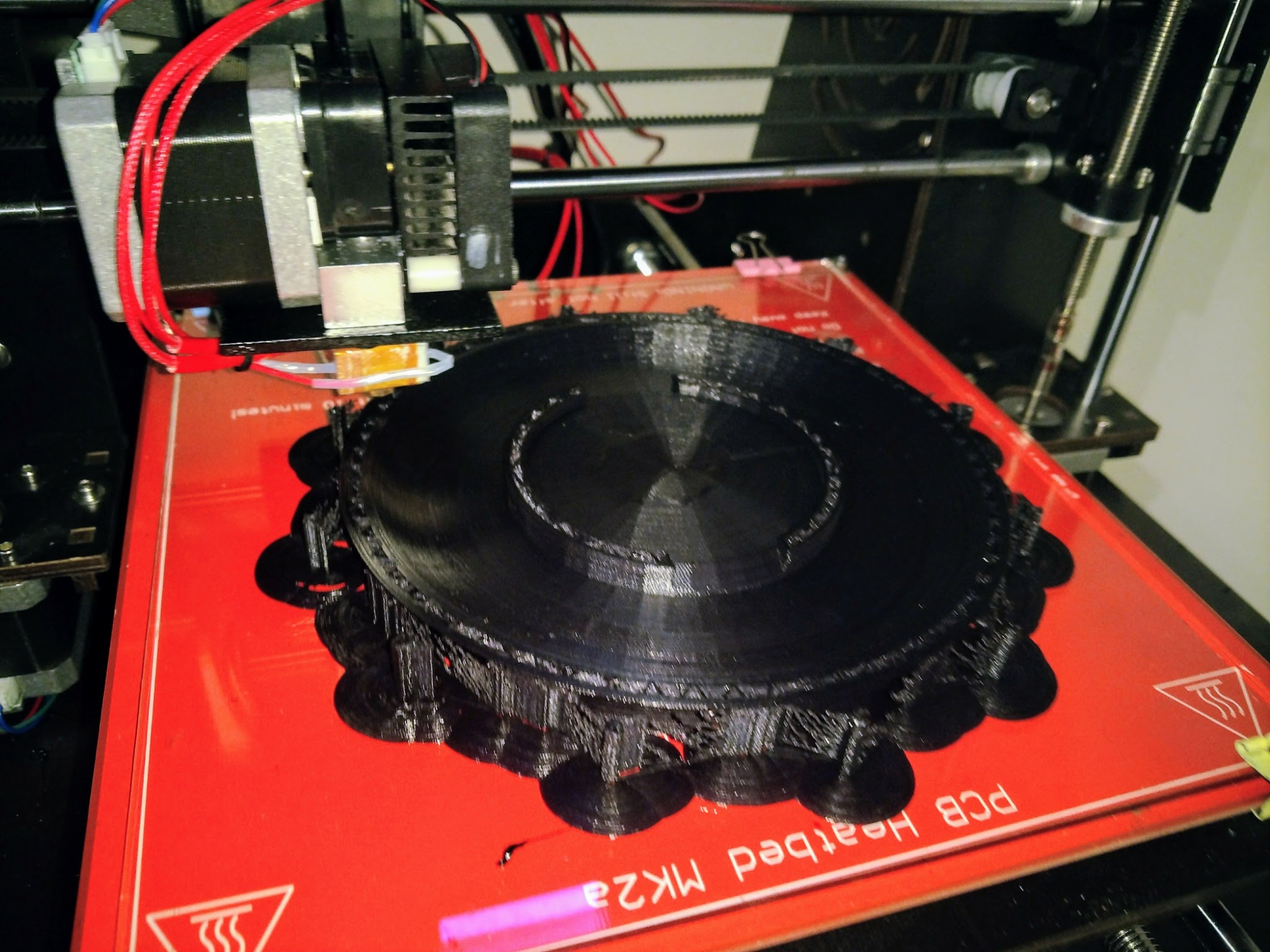

@John_Kelleher it’ll probably take a while for you to figure it out. It’s not something cool. Lol. 23 hours in!
I’m now at 24.5 hours and it’s looking pretty good but I’m only at 17%… It seems like if it was suppose to take 56 hours that it should be at about 45% not including me turning it up to 150%. What gives?
%age though the GCODE file and %age through the time may be very different. If it has large moves near the beginning of the job but lots of tiny moves towards the end then those tiny moves are a lot of GCODE, but not necessarily a lot of time.
Or to put it in more technical terms: is it pointy?
@Mark_Wheadon ​​ no, it’s not pointy. But that percentage, what is it actually stating? The percentage of total moves it has to perform or is it layers? Because if it’s layers, that’s much more understandable. Once it gets a little bit higher it’ll start moving through the layers a lot faster. The base is just really dense. About another inch or so up and it won’t be printing much of anything except the sides.
It’s how far through the actual text file you are. The gcode file. So lots of short moves will take up lots of space in the file but not take a long time.
@Mark_Wheadon hmmm. I guess we’ll have to see. I’ll keep posting pictures and see how it progresses.

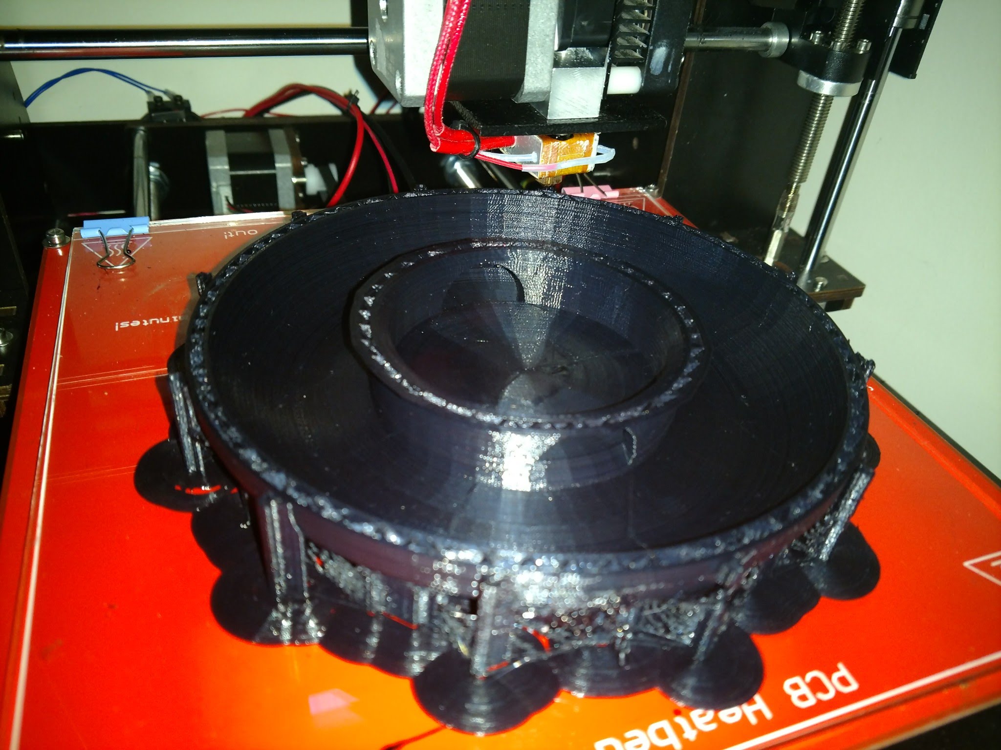

29% at 31.5 hours and counting!
Please do! I can’t believe how anxious I am to learn what your printing. :slight_smile:

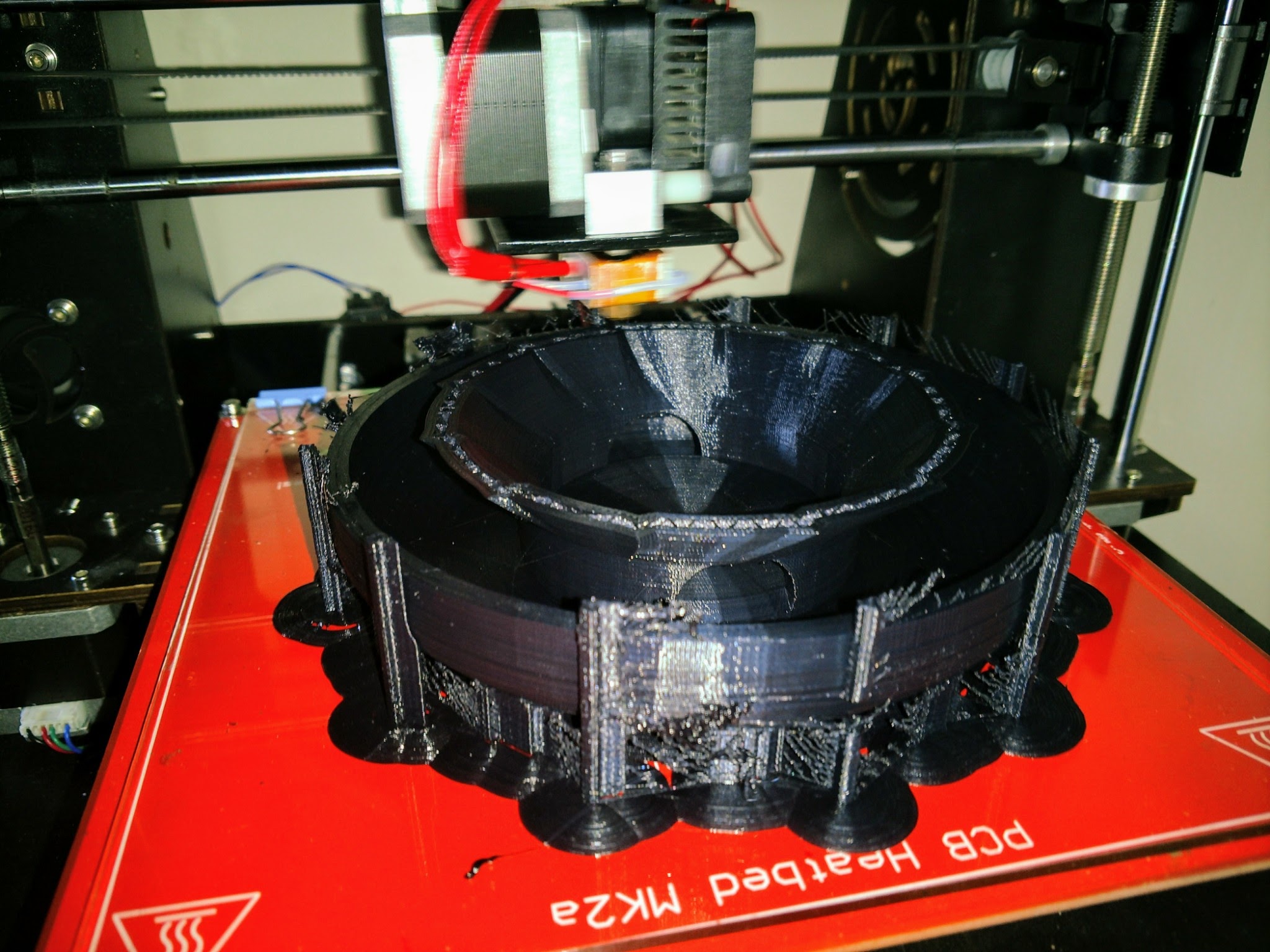

Check it out, I hooked up a live feed camera so I can see it from work because I’m a nerd like that. Lol. It’s even got night vision! Should be at about 34 hours now.

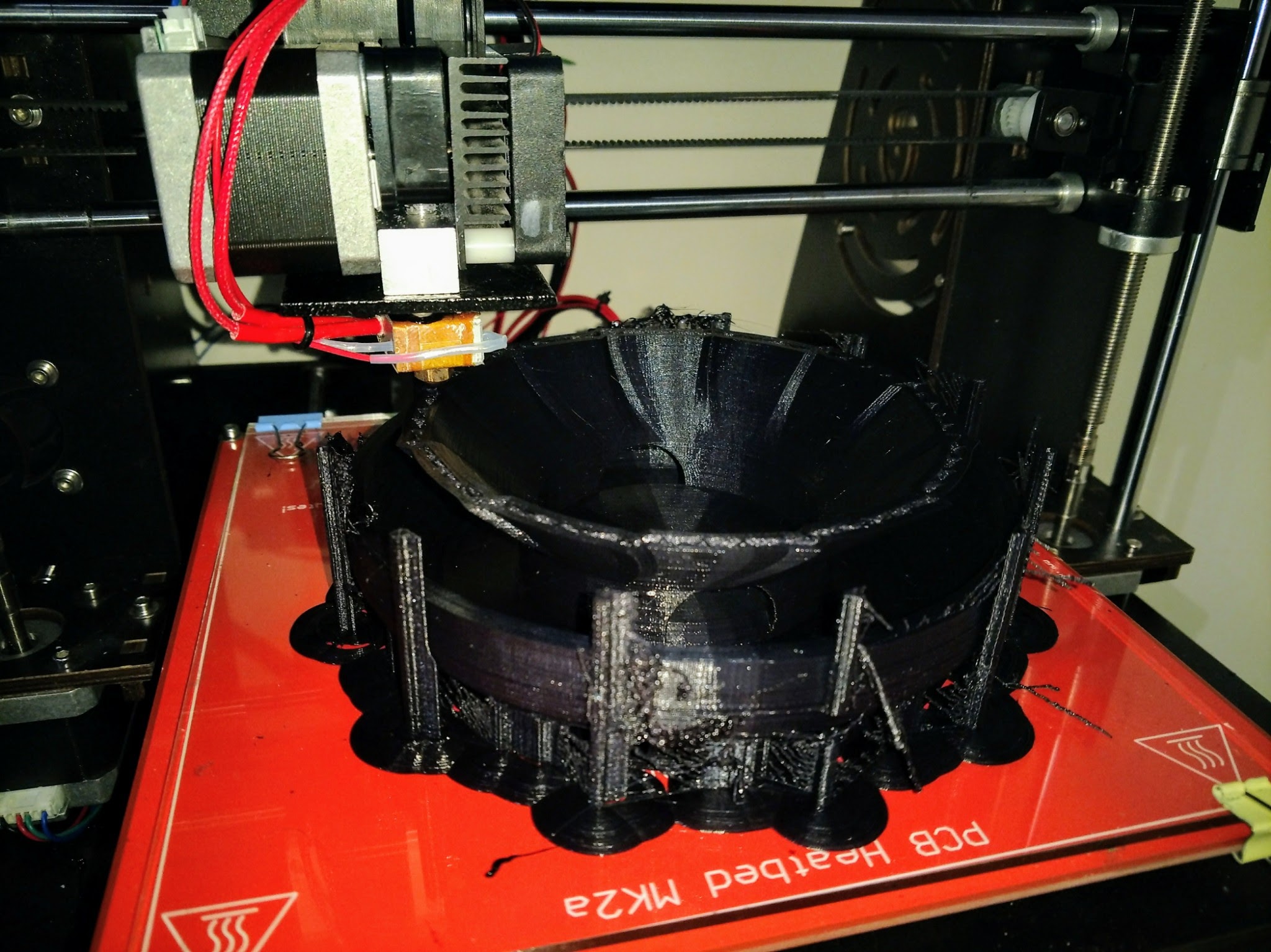

41 hours and 43% done.
45.5 hours at 50% I ended up losing 3 of my support towers so hopefully that doesn’t cause any issues. So far it seems to be doing fine without them.
