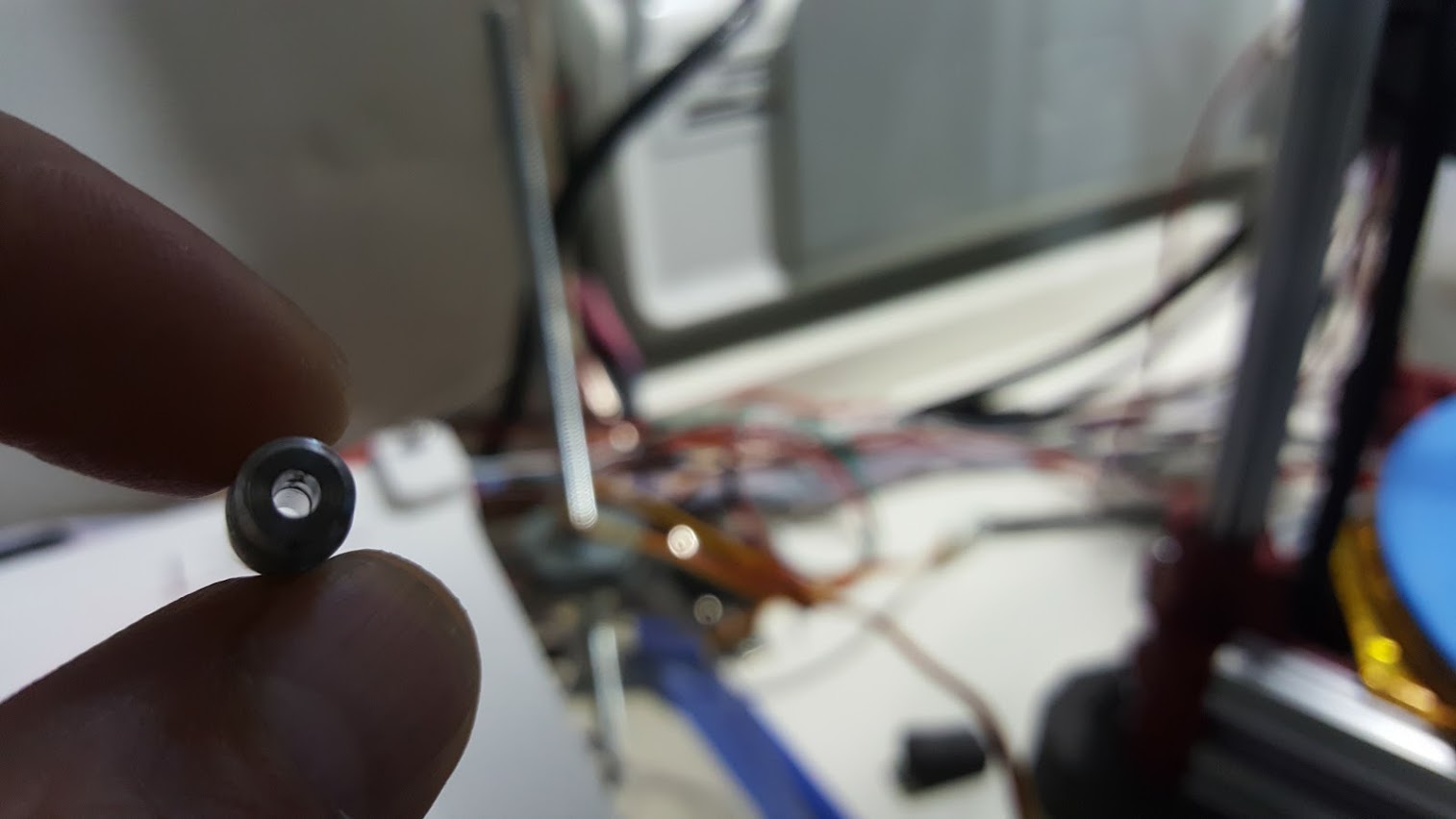

Edited: Cleaning warning. this is the throat of the brand new E3D hotend I
Edited: Cleaning warning. this is the throat of the brand new E3D hotend I got, large step and large lump on side. It is grease and dust of metal from machining. Clean your new hotend before you use it. It may take more than hot water to get the grease out, rubbing alcohol and paper towels (TP) twisted into a stiff ‘tube cleaning thingy’ worked for me. The marks on top of the heatsink are from inserting the bowden brass ring and are normal according to happy users. If you box is smashed, it may or may not hurt the contents, check them regardless of the box condition, especially the thermistor. Hope it all works, fingers crossed.

I’d try getting them to ship you a new heat-break (FO’ FREE!), but nothing else is worth complaining about. The dented box didn’t put damage on the inside of that break. And the little bit of marking on the E3D v6 main body isn’t going to affect its performance and is completely normal for these products.
The metal dings you see, simply come from mass production. When you’re making these things in batches of 1000, they’re milled and dropped into a big box. They’ll get dings from the drops and they’ll get dings from others dropping onto them. These are not artisanally crafted by-hand one-offs.

I already talked with them and the $10 for shipping was their compensation. I guess I just expected so much more from all the descriptions of polished throat and nozzle. If this is normal then they don’t owe me anything but from my machining experience I feel the cost/value for me is not good. The reply I got about how the customer service person has never had box damage issues before, its like seriously? Ship much or just BS a lot? I am not going to waist the effort if they think ‘our shipping is perfect’ is realistic. The subtext of the reply was that I caused the damage somehow. what effing ever.

After soaking and further scrubbing, that mark in the throat is not a disfigure in the surface, it’s dirty grease, from machining I guess. dark black gunk. so the throat actually looks ok after cleaning. however, if i had used it out of box without careful checking i would have grease with bits of metal in it shoved through nozzle by filament.
$15-20 chinese clone, sure chuck it in a bin. $50 I thought I was paying for quality better than mass produced chucked in a bin.
