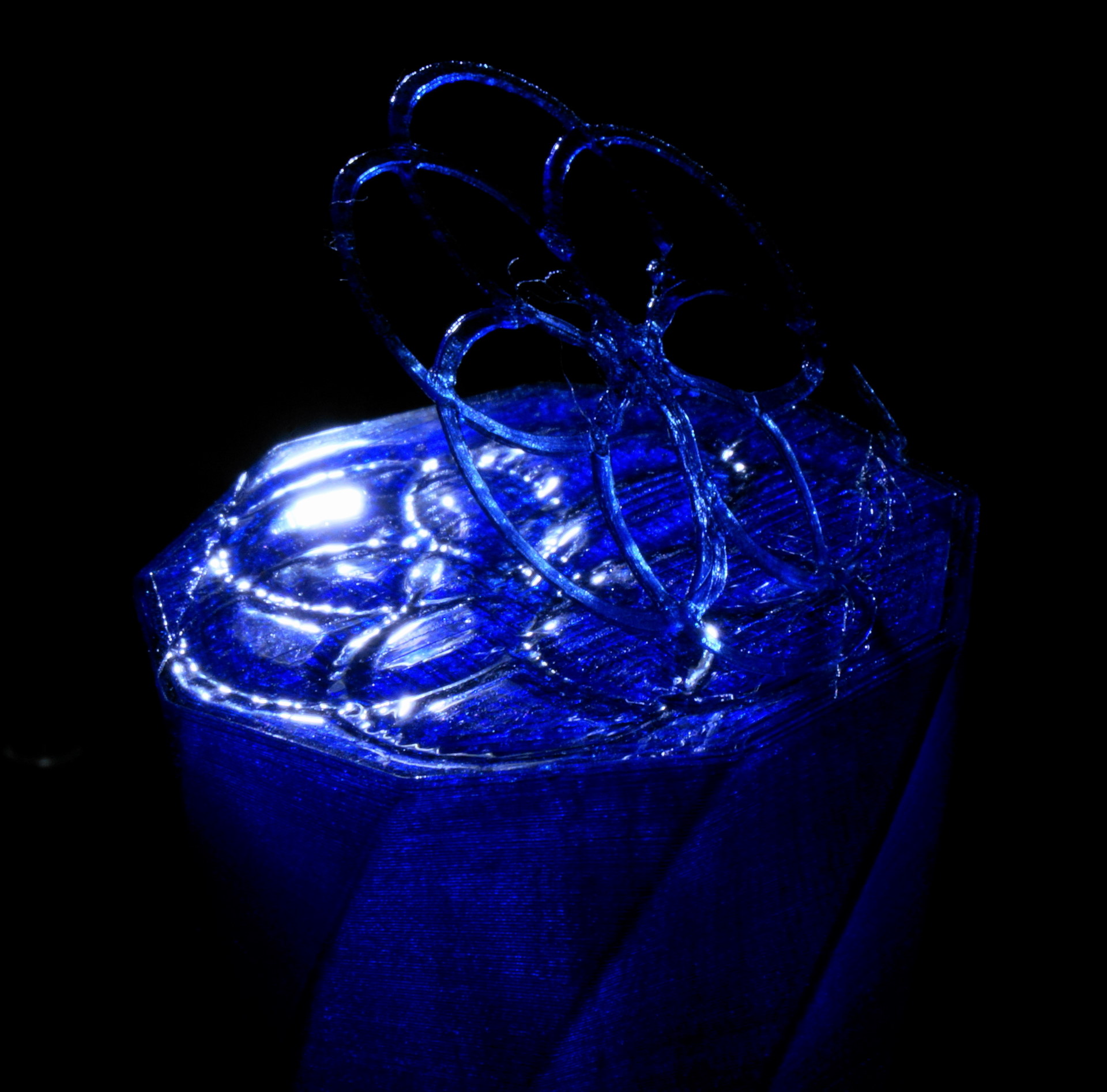

If you print 1 thin Base layer (0.1mm) and foiling it with Kapton before you printing your actual model ontop (ensure clearance choosing first layer with 0.2). You can have shiny imprints … (only low resolution)
Second Image: Letters printed with PET, while still left on the hotbed i let it cure for 1h coverd with a low temp. melting plastic–PCL (https://en.wikipedia.org/wiki/Polycaprolactone ) which will then infuse your print.
