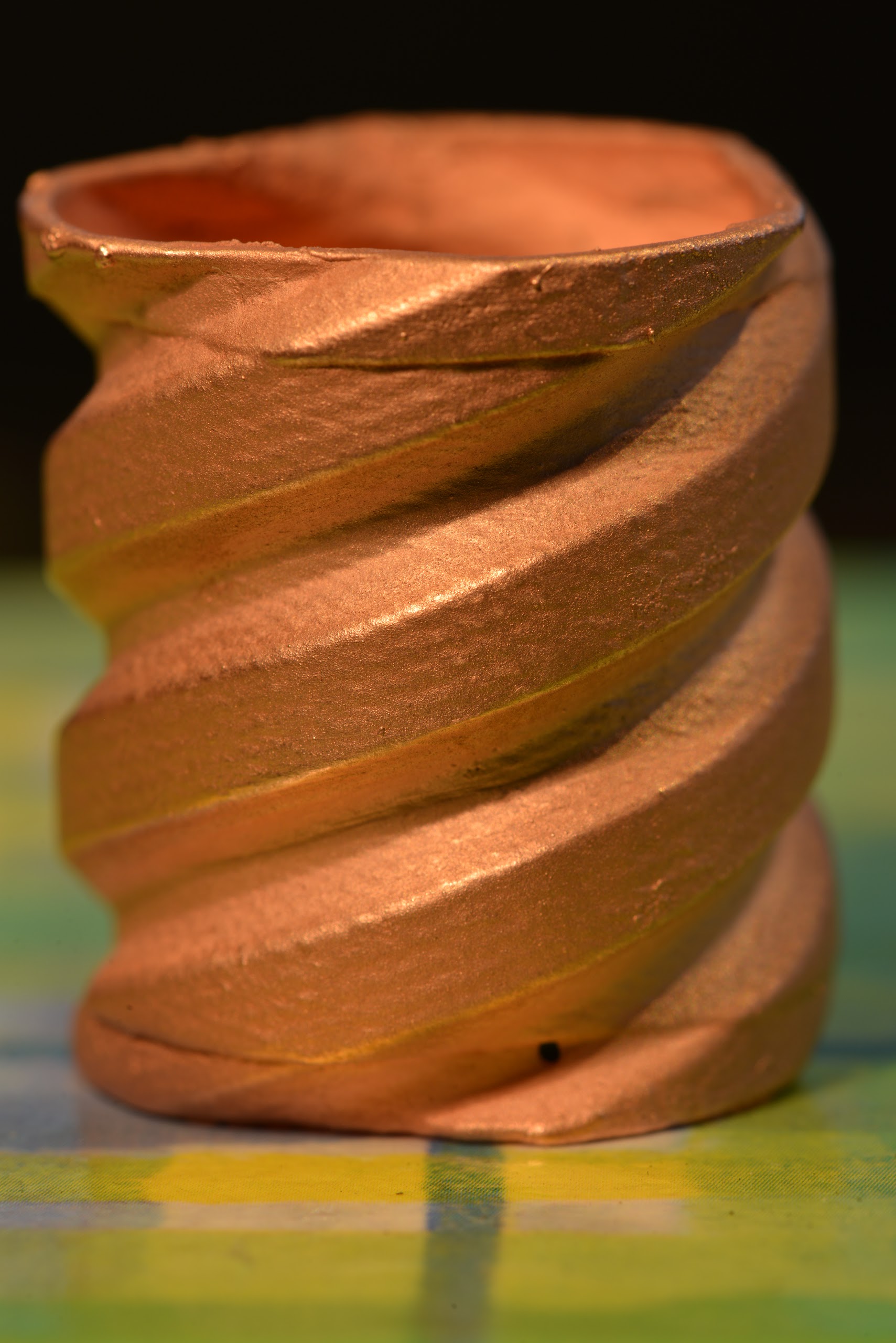

Electroplating Electroplated screw (generated with  https://github.com/hzeller/gcode-multi-shell-extrude ; this is printed with lock-offset,
Electroplating
Electroplated screw (generated with https://github.com/hzeller/gcode-multi-shell-extrude ; this is printed with lock-offset, this is why it has the little offset at top and bottom. ).
(This is a followup experiment of one of my earlier posts https://plus.google.com/u/0/+HennerZeller/posts/QJraphZVBng
See preparation of item there)
This time with proper ‘standard’ bath (CuSO₄, H₂SO₄, few ppm HCl, some PEG) and moving electrolyte (with aquarium air bubble pump). About 200A/m² (in this case about 50cm², so about 1A).
There are small dimples on the surface, and some more sanding can make it shiny, however, that is not really easy in intricate shapes.
So, next step would be to figure out formulations to decrease need for post-processing, i.e. less dimples.
So I might try less current for slower depositioning.
Also there seem to be some improved chemistries that help improving that as well. Does anyone know papers that describe improved, smooth depositioning ?
Nice try, in my job I do it regularly.
For better plating results you need more special chemicals liks brightener.
But an easy way to archive better results is pulsplating.
Its only. A controller and a H-bridge (mosfets)
You change periodically your DC current, to reverse so it dissolve a bit of copper. Next cycle it puts in forward mode copper onto your object and so on.
Forward cycle is a bit longer as reversed cycle.

Hi, if you message me your address I’ll drop a sample of brightener in the mail. I beat my head against the problem you’re having for months. A teaspoon of brightener in a 1 gallon bath will get you the result you want. Alternating the current as someone suggested is helpful, but only part of the solution. Also, PEG is a vital part of the additive you’re looking for. But, the remaining variable in the equation is an industry secret. I noticed that a post was deleted from the http://finishing.com forums because the guy included results of tests he ran with a mass spectrometer… (One step short of busted knee-caps.)
@Bradley_D_Woods if you interested in the recipe of brighteners a good tip are the patents :stuck_out_tongue: but the chemicals involved are often hard to get ,but you can talk to firm in your near that has in example a copper plating bath. Maybe the sell you little amounts.
But if you are lucky, a problem remains, that chemicals need adjusted and that realy exact in ranges like 10g /litre
Normally you titration, but you can do it with a so called “Hull-cell” but that needs trying and experience.
