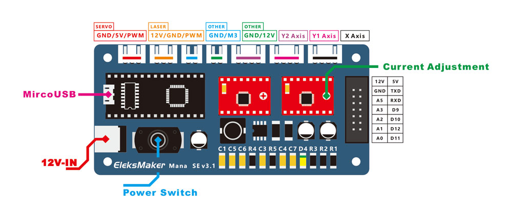

I have an EleksMaker ManaSE v3.1 plotter on which I would like to mount a laser that needs two command signals: a digital signal (0-5V) for enabling (on / off) and an analog signal (0-5V) to adjust the power. By applying a low pass filter to the output of pin 11 (PWM) I should get the analog signal I need. But where could I get the digital on / off signal instead? Generally on CNCs based on GRBL firmware it is pin 12 that gives the enable signal, but on this board it does not seem to be connected. Do you have any suggestions by chance?
In the attached image you can see that there is a connector called M3, which in the Gcode indicates the enabling of the tool, but I don’t know if it can have that meaning on this board

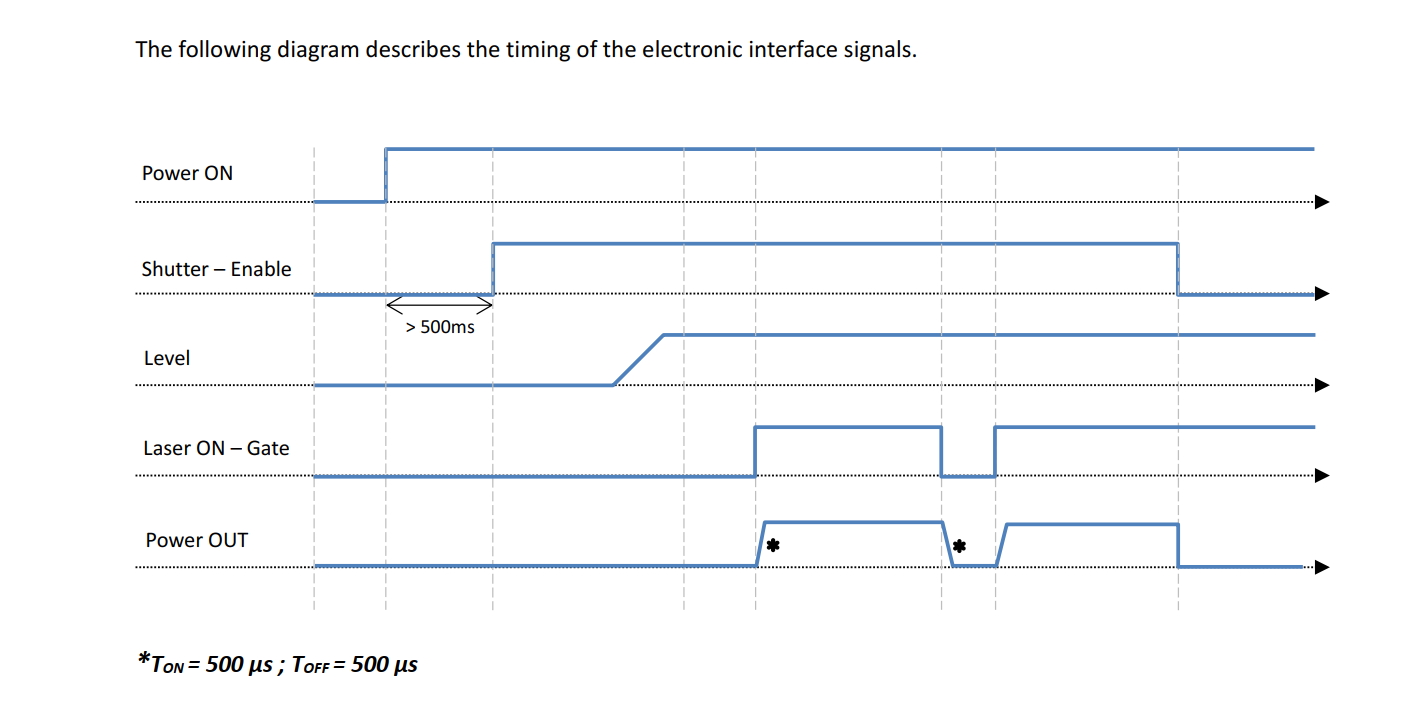

The forum does not allow me to attach the manual of the laser system, so I insert a screenshot of the signals
If the manual is online you can provide a link to it. I did not find it on the manuf web site.

The M3 output looks interesting but without the schematics I cannot tell how it is implemented?

On older GRBL (< V1.1), D12 was spindle enable, but since V1.1 D11 is spindle PWM. D13 always was spindle direction. See Connecting Grbl · gnea/grbl Wiki · GitHub
The gcode command M3 means spindle on clockwise, so I guess the M3 port is connected to D13. If so, you could use that port to enable your laser. Just try with a voltmeter if an M3 command delivers 5V on the M3 port, and M5 stops the signal.
Yes that’s correct. In laser mode $32=1, the spin dir port becomes the laser enable signal.

I did the test you suggested and effectively by running the g-code M3, on the M3 port, I read a voltage of 12 V. Instead with the g-code M5 I read a voltage of 0V.
Honestly I expected a 5V signal, being the ManaSE board based on Arduino Nano, but I could still take advantage of this signal by inserting a module that transforms 12V into 5V.
An oddity that I found however is that by testing the GNDs of the other ports I never get 0V but about 1.3V

I am guessing that the GND/M3 output is actually motor control and you would expect that to be 0-12V.

This is the old EleksMaker SE.
Note that there are two versions of the Mana board and the difference are
---- ConnectorTable ----
Ref# Old Label New Label comment
1 Servo Servo xx
2 Laser Laser xx
3 n/a Other (M3) this is new with m3 control
4 Motor Other (12v) this is the old motor control
5 Y2Axis Y2Axis xx
6 Y1Axis Y1Axis xx
7 X Axis XAxis xx
Note that item # 3 is the main difference and I think it has been added to the new version.
You can find what Mosfets are driving these outputs (drain) and then trace back their inputs (gate) to the Arduino pin. Once you know what Arduino pin we can identify its actual function.
When you find what MOSFET is driving the M3 connector we can understand how it is switching 12V and potentially replacing its 12V drain connection with a 5V one to get a 0-5V laser on function.
Be aware that the laser mode was just added in version 1.1 and doesn’t exist on version 0.9.
In Laser mode ($32=1) the laser power is adjusted to the feed during accelleration and decelleration when using M4 instead of M3. This results in cleaner edges. Without that feature the start and end of lines always got overburned.
If your board is made for GRBL v0.9, it can’t just be updated to v1.1, because then D11 and D12 will be swapped. You would have to cut these traces close to the MCU and cross them over.
I understand, thanks for the clarification
I have found a MOSFET and it should be the irlr120ntrpbf. I tried to follow the traces with a tester, but the gate doesn’t seem to go through Arduino but go directly to a resistor R1 and then to a capacitor. Unfortunately, following the traces is rather complicated. Probably the simplest thing to do is to make a voltage divider that transforms 12V into 5V
Did you check the gate to every pin on the Arduino?
Hard to believe it not driven from the arduino??
There probably is a gate resistor but it should still connect back to the Arduino.
Did you trace the drain? Where does it connect?
I retried the test and effectively the gate should be connected to pin D11
It is connected to the positive of the M3 port
