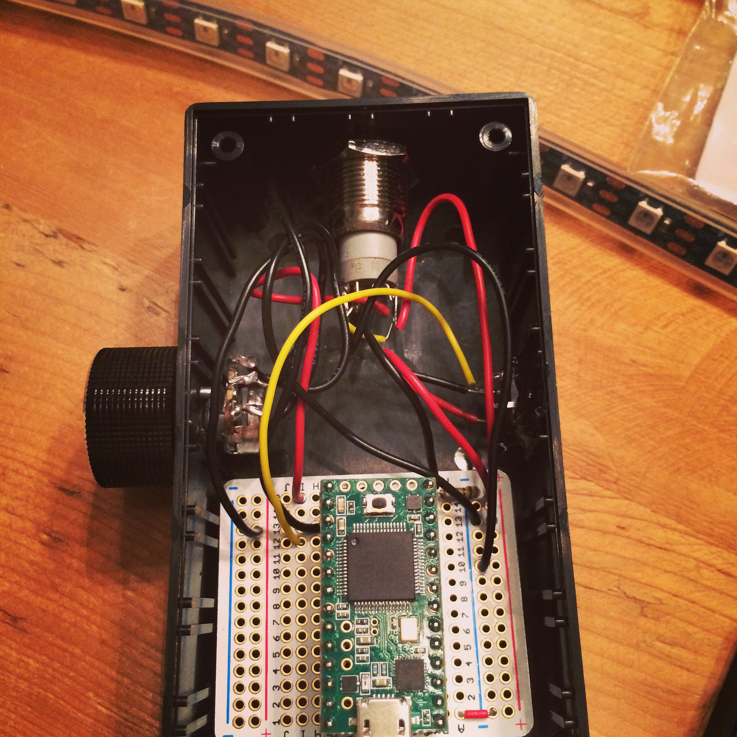

Enclosure for my custom LED Bike controller.
Enclosure for my custom LED Bike controller. Teensy 3.1, Power on/off, momentary press for pattern changes, mic input for audio based patterns, potentiometer for hue/brightness control. The bike will have a strand of 300 ws2812b leds running various fastLED based patterns I’ve culled from the group.

sweet! nice clean box setup
@Robert_Atkins I’m using a 5Ah 12v battery that will be mounted on the bike. I still have to finish getting the LEDs onto the bike and wiring up power to the VIN on the teensy and the LEDs with shared ground. I have a 12v to 5v voltage adjuster to get to the right voltage for powering both. Hopefully I’ll get a full night’s worth of power out of the system before having to recharge the battery. Yes those power buttons are expensive! Sexy white led backlight though!

I used too small a box to fit the converter. :O. I have a larger metal enclosure I could use for the next bike that would easily fit the whole power circuit sans battery but I was slightly concerned about heat and sun exposure.
My adventures tonight have convinced me that nobody who manufactures electronics project boxes has ever done any electronics, I feel your pain :stuck_out_tongue:
